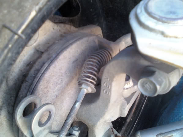

this is the one that i need to get off
this is the broken one
