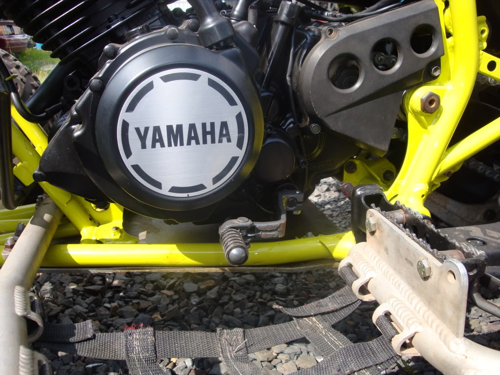

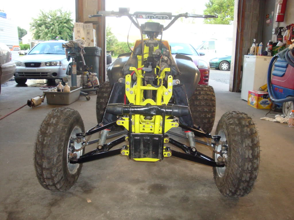

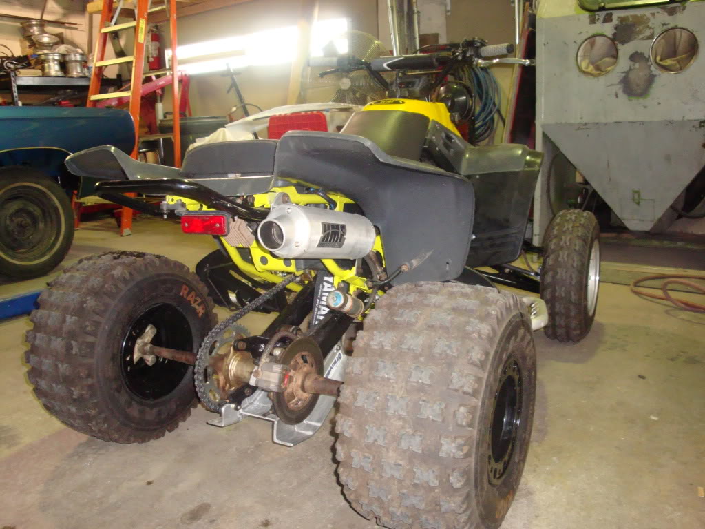

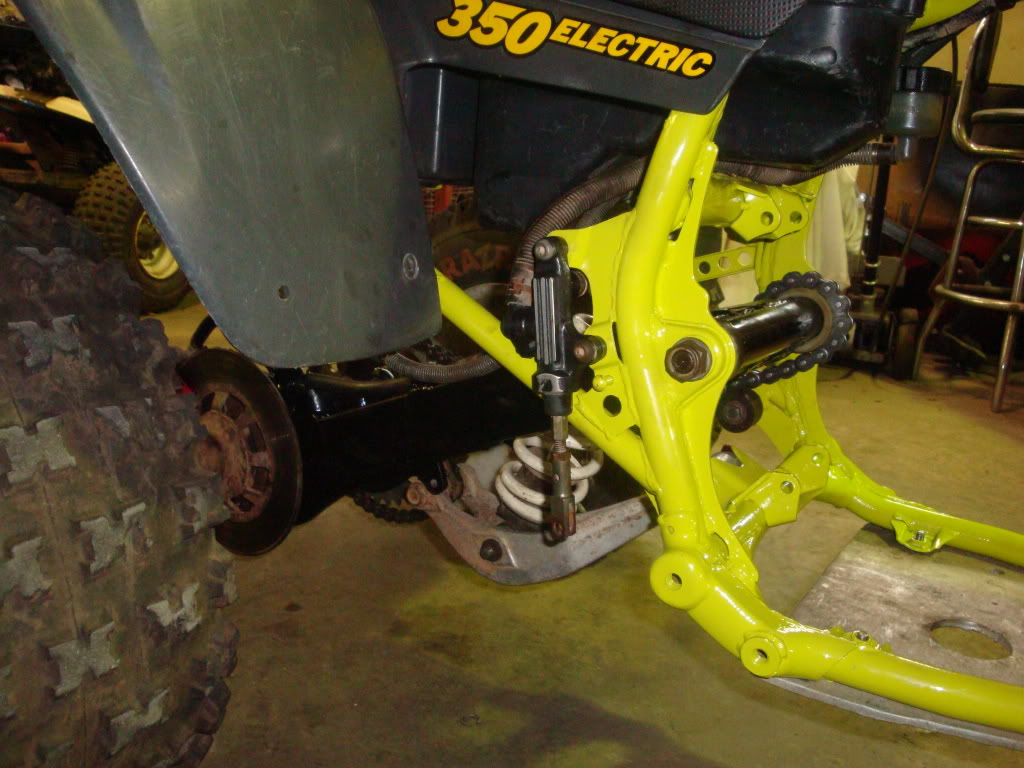

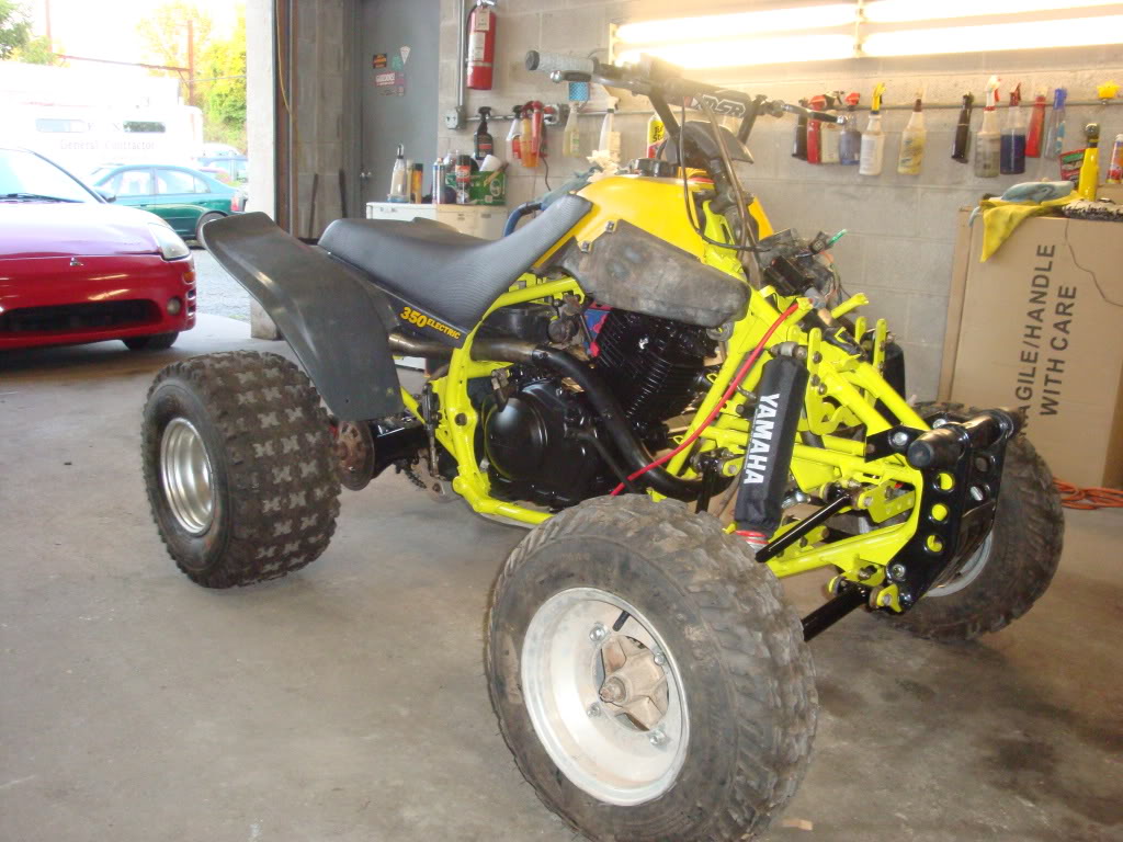

Hi, I am new to the forum and also new to Yamaha.
I picked up a 1987 Warrior for my wife. I am having problems getting it to run. I have completely rebuilt the bike from a bare frame. I can make the bike run if it is oulled with another vehicle but as soon as you slow down to unhook the strap it dies. I can not start it with the electric starter or the recoil starter. The bike started before it was disassembled but ran poorly due to excessive clearance in the cylinder bore. I have tried changing the Stator & CDI with both the old ones and new ones and it does exactly the same thing. I have removed the entire wire harness from the bike and checked all connectors and checked continuity on every wire. Everything tests good. I have tried 3 different coils and spark plug wires. No difference. I am not even worried about the carb as it will not even run on starting fluid. I do not seam to have enough spark when cranking. The orange wire from the cdi to the coil does not seam to be getting power.
Any ideas would be great as I have absolutely no more ideas on how to fix it and I have spent a good 30 hours or so trying to make it run.

Pics:
