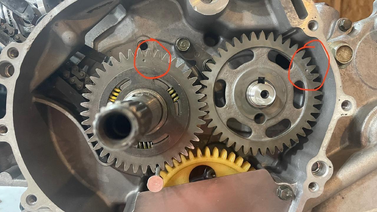

Old Sep 12, 2023 | 04:52 PM
Tucker17's Avatar
Joined: Sep 2023
Default Counterbalancer Gear Mark issues
I'm having a similar issue not sure exactly where the mark on the counter balancer should line up any information would be great
