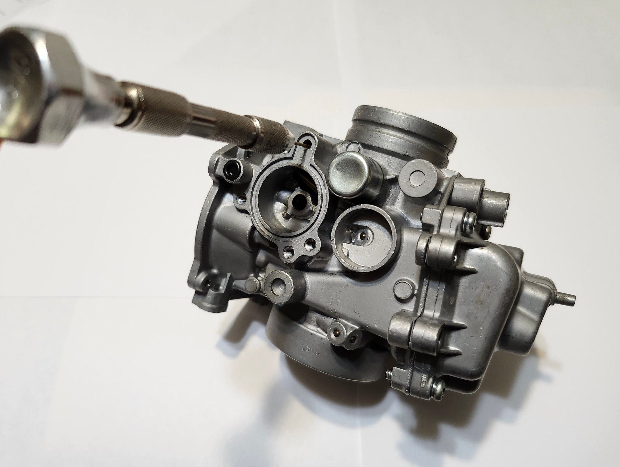

I don't know the history of the carburetor on my recently purchased 2003 Bear Tracker 250, but the ATV wouldn't accelerate when giving it throttle. If I feathered the throttle it would eventually increase in speed but if I gave it a quick throttle demand it would almost stall out. I started out changing the CDI box (no change), spark plug, then started rejetting, changing float level, checking valve lash, a second CDI box thinking I got a bad one, etc., etc. Long story short, when demanding power the acceleration circuit was not operating properly, causing an over lean condition. There is a drilled passage from the exit side of the carb just downstream of the butterfly that leads to the top of the acceleration diaphram camber. The passage has a brass orifice on the diaphram side which was 0.035" with a passage below it of 0.018" causing too much restriction, and a very slow response of the acceleration circuit. I drilled out the orifice and passage to 0.038" and it corrected the problem. That circuit allows vacume to quickly open the enrichment valve, and pull on the top side of the main diaphragm during high throttle demand, raising the tapered needle for the correct fuel air mixture. I also opened up the passage in the upper diaphram cover for faster diaphragm response. The passage is almost 1/2" long so go very slowly to avoid breaking your orifice drill bit.
