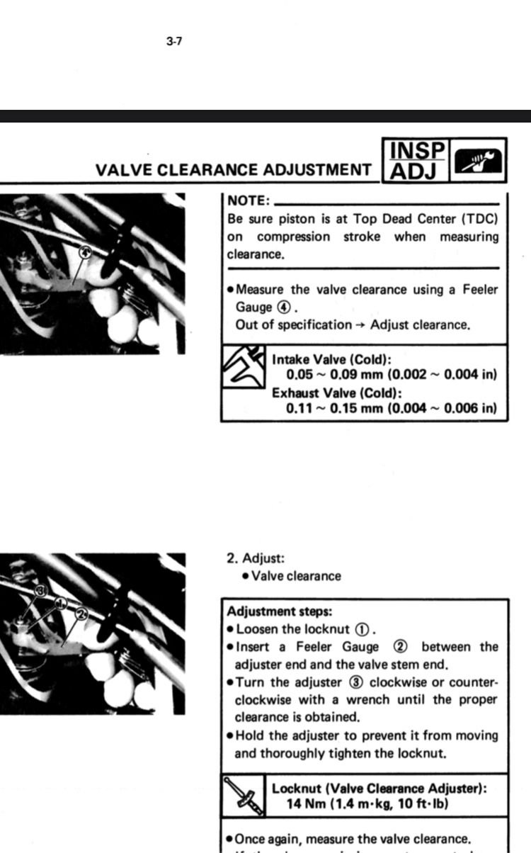

Hey y’all, buddy of mine picked up a 1989 Moto4 250 in a trade. Starts fine, but needs a little work that i agreed to help with. Can hear the valves ticking when it’s given a little throttle, was wondering if anyone has a repair manual so we can get the clearance right. Tried looking through the internet for answers, but didn’t find anything for this exact year an model. Not sure what years would be the same. Thanks in advance!

Broke down an bought a repair manual, I’ll post the clearances in case anyone else has the same question.
