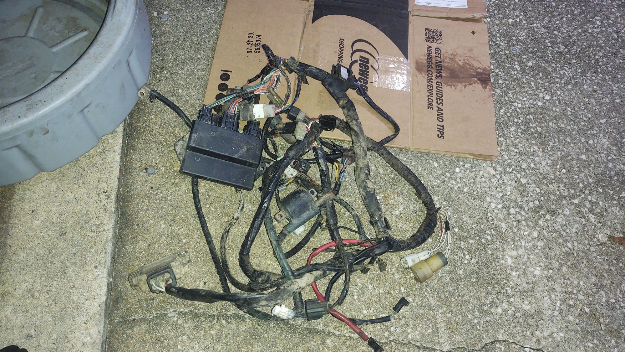

Well I scored a deal! Found a guy a couple hours from me who stripped down a 4x4 for parts (damaged frame I believe it was), so I made the drive and picked up everything I need for the swap, and then some! For the price, I simply couldn't pass the deal up!
Ended up getting the main ingredients like a good running 4x4 engine (so I don't have to tare my 2wd engine apart!), the front diff and actuator, CV axles, front drive shaft, complete wiring harness (complete down to the CDI box), and ended up getting a ton of extra parts as well like an original Mikuni carb, front struts, control arms, knuckles with good bearings in them, handlebar assembly, oil cooler and fan, and a bunch of other odds and ends. More than enough to do the swap and still have spares, and I'm hopping I can sell my 2wd engine when all is said and done for a little kick-back on the project investment

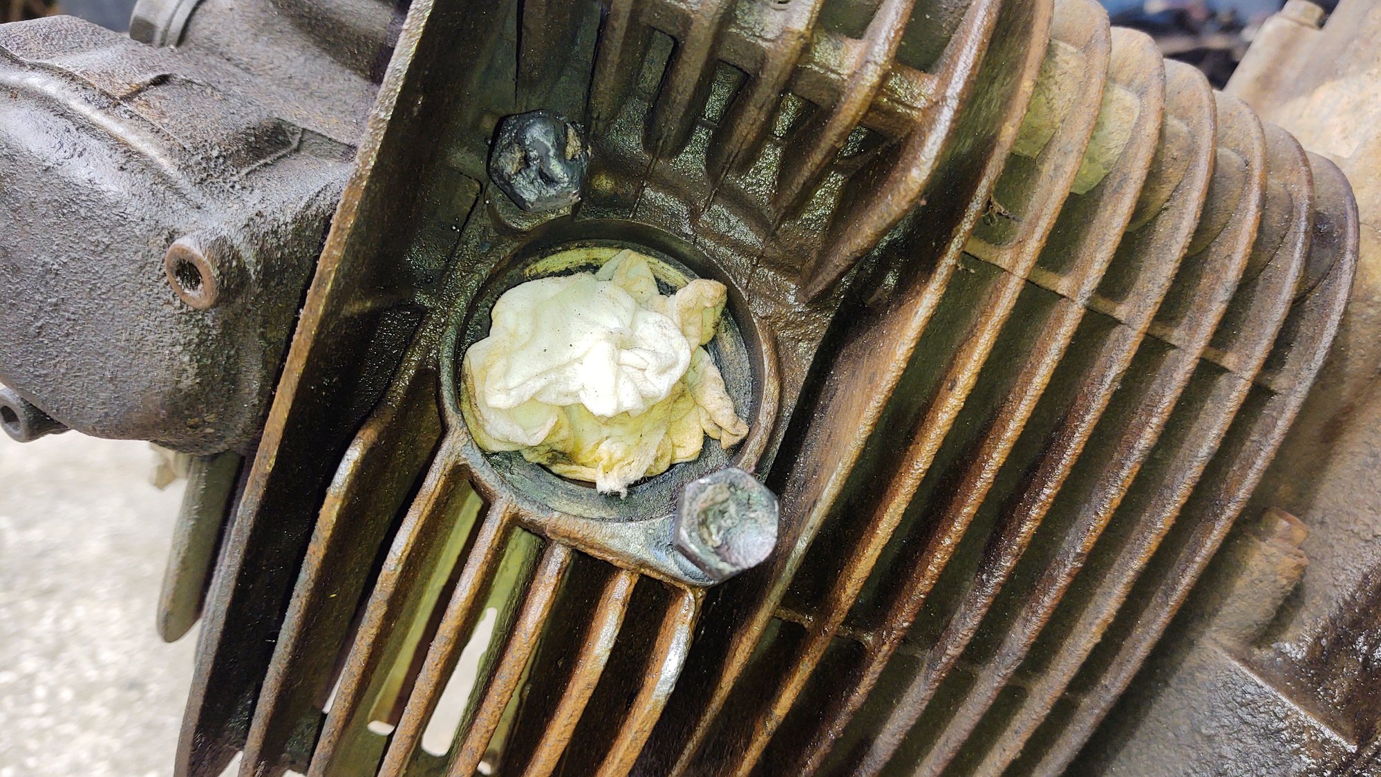

The first chore before anything else is to get these two broken exhaust manifold studs out!

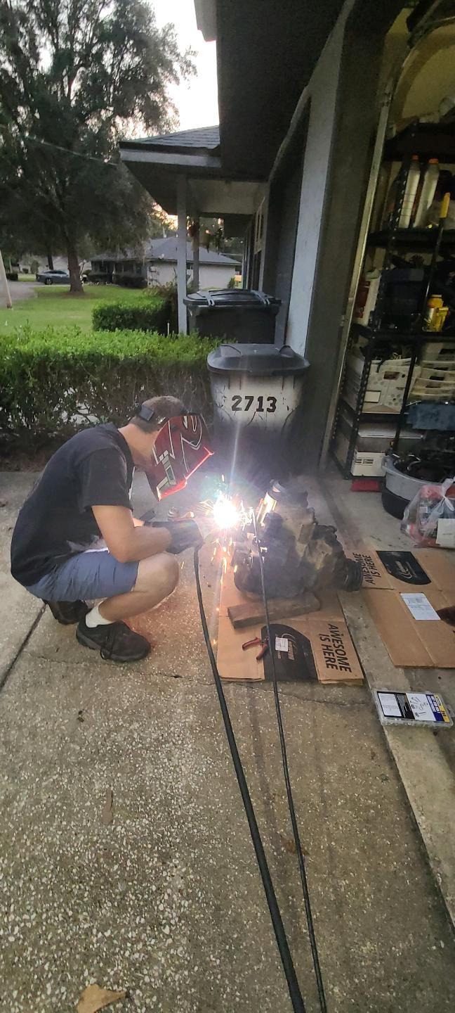

Started to mess with the broken studs today. The first one I tried just clamping some vise grips onto it. Got a good enough hold of it to break it off further lol. So there's just a nub left of it. Instead of using the vise grips on the other stud, I jumped straight to welding a nut to the stud sticking out. With that, I was able to back that one out with little effort
So tomorrow I'll try to weld a nut (possibly a washer and a nut) to the stub left of the other one and see if I can't get it to back out too.

I always go for the welding torch to get broken studs out in aluminium, if I can without setting other things on fire or melting plastic. I use it on brake pad pins, having rounded a few of the allen screw heads off. Now, if they are tight at all, first resort is to heat the caliper up, works every time, but sometimes the caliper has to get very hot. Best of luck with the project.

Success on the studs! Managed to get a weld to stick to the stud and a washer and then a nut and was able to back out the second one!
Chased the threads with a tap and they're nice and clean.
Have new studs and nuts and a doughnut gasket on the way as well

Yeah my cheapo Harbor Freight 90 amp flux core welder has come in SO handy to have in the garage! This is the first time I've ever attempted the welding on a nut technique. I'm definitely a beginner when it comes to welding, but I can sure make a bead that looks a heck of a lot better than some others that I've seen lol.
