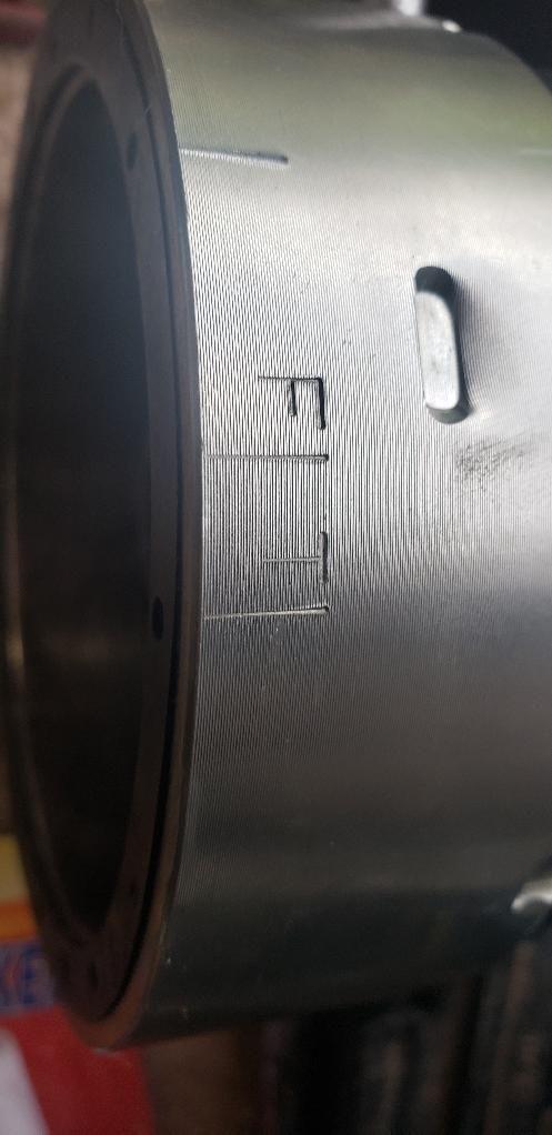

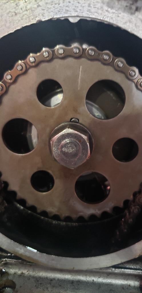

2. I have pictures of the timing marks and don't feel they are lining up as well as they should. In the manual and online i read about the T mark which is what i used. There is also a line right after the T which makes me wonder if that's the line. The Line on the top of the gear which is supposed to be lined up with the mark seems out by 1/2 link (see pics). Is this normal? Should i try setting it to the other side of the Mark to see if it makes a difference? I also took a pic of the original flywheel with the same marks as the one installed. In the manuals they show a line under the "T" mark, clearly mine don't have that. Is this close enough or should it be moved over a tooth? Pictures where taken with Tension-er Installed and set. One final note, i do realize in the pic the T looks a bit off, even when it's perfect it still appears that the top mark is still off by 1/2 a link.

It is the line beside the T mark that you set the timing by. The one by the F would show up if you put a strobe on it for ignition timing, don't know why they bother, as the spark has to be "right" by the flywheel because it is fired by the flywheel. You can only set the cam to the nearest tooth on the sprocket. If they are half a tooth out, I set them so as the chain wears and stretches it will get nearer to "right".

so today i went back out, put a new air filter and spark plug in (arrived via amazon today). Buttoned it up, messed with the idle screw a bit and got it running pefect for the 10 min it did. Then it stopped. I had forgot that i had loosened off the cam gear bolt, it backed out and here is the result..... Looks like i'm gonna need to pull off the bottom covers to find the pieces.....and get a new cam For those who don't know.... there is supposed to be a hardened pin where that hole is. Now there are bits, and a pin in the bottom of the engine.

I fiddled some more after work and finally got it running perfect. Then, the engine failed becuase i had forgot i had loosened the cam gear and it backed off. This caused the gear to break off the pin in the cam shaft along with bits. I am also suspecting this is an interference engine ? I just want to cry lol
