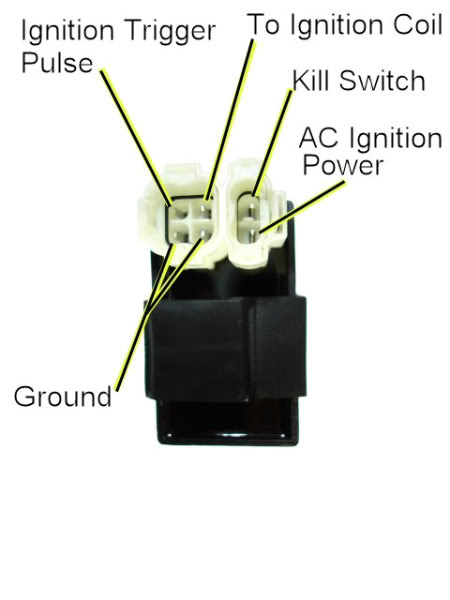

got a 03-04 camando hunter 250 and it dont have no spark

im not sure what the problem is it turns over but theres no spark. im thinking its the CDI box but im not sure. please contact me with more information at joshua_seversom@yahoo.com

I've not heard of this quad, but that is not unusual considering the zillions of chinese brands.
Is this a picture of your CDI?
If so then unplug the CDI, turn on the ignition switch, and put all your kill switches in the run position. Measure the resistance of the kill switch pin at the CDI connector in the harness to ground. It should be open. If it is shorted to ground you have a kill switch problem.
Most no spark problems have to do with kill switches or kill switch wiring. We can do further tests based on these results, but this is the place to start.
