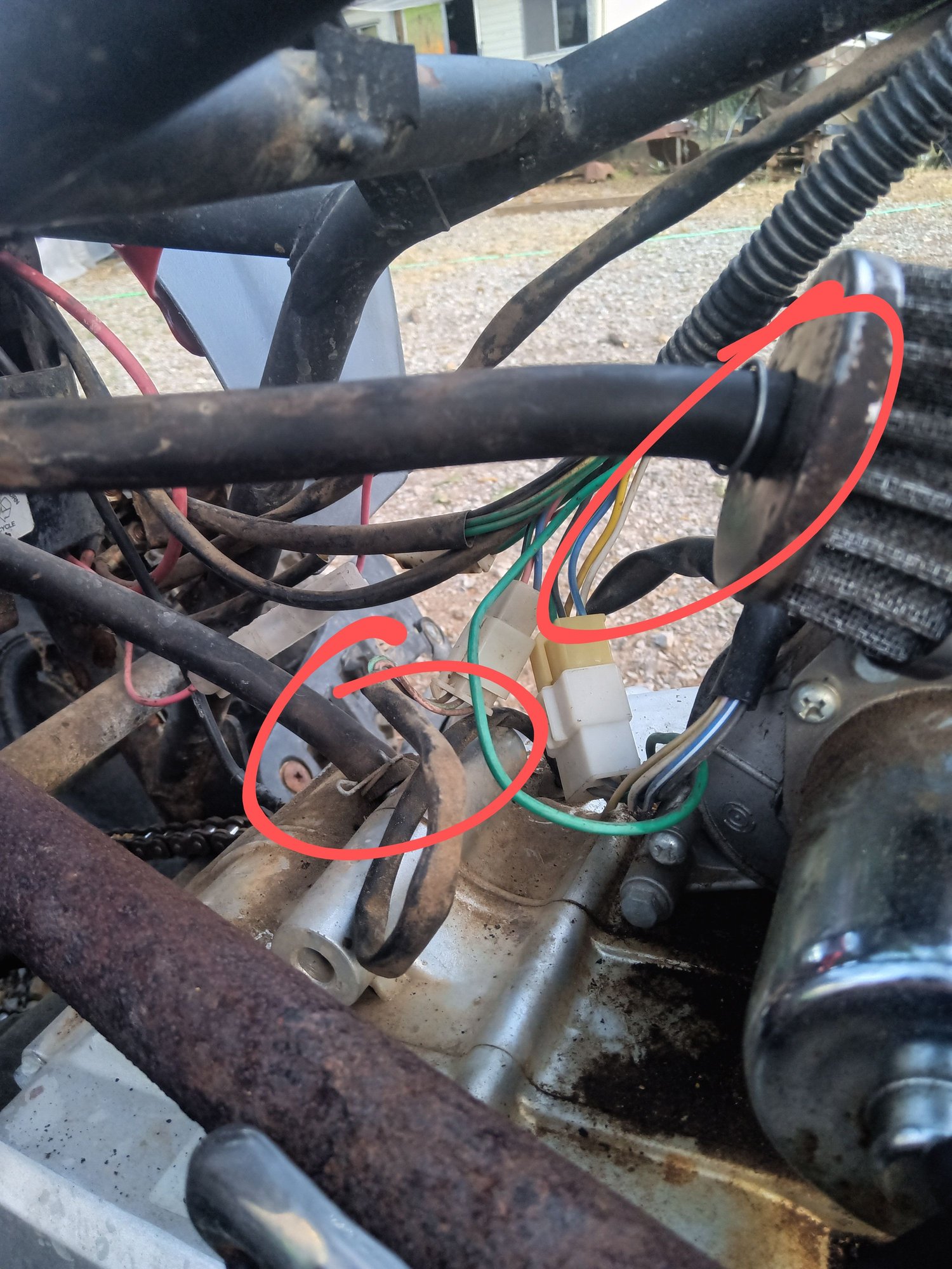

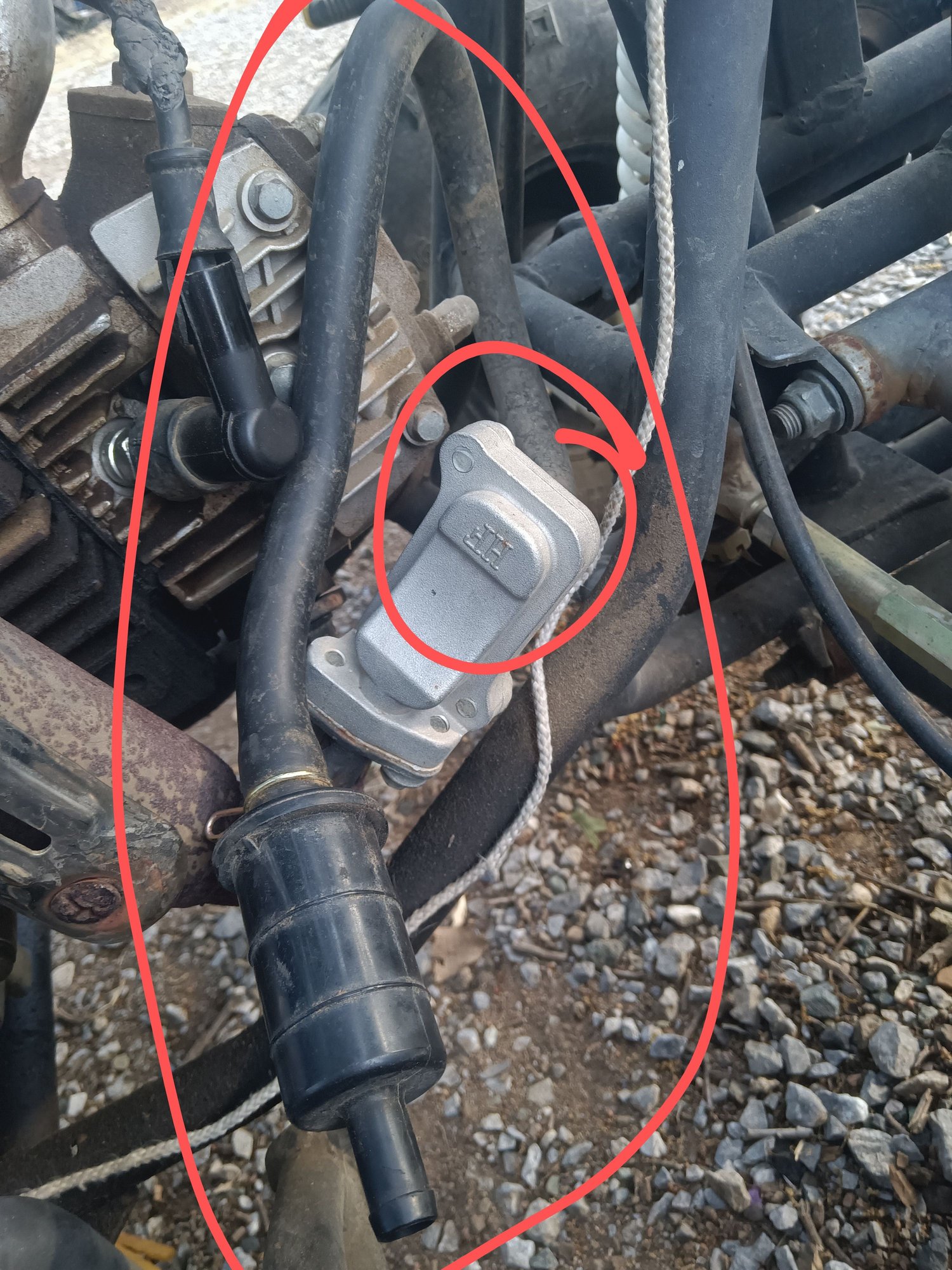

Default Can anyone tell me where the HF hose that comes off the exhaust goes?
I'm having trouble withy sons Chinese quad I need manual or a diagram of where the fuel lines and the vacuum lines go please!!! Also there's a hose the in the second picture that comes out of the case and it looks like someone punched a hole in the top of the air filter and stuck the hose in there but it doesn't look right. And I am unable to find a manual or a video that will show me where they go so any help is greatly appreciated please
