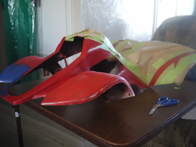

After getting the body off I found the (this is an official term because I am having a brian block and cant think of what is is called) Thingiemabobber that make the starter kick in. Shorted across the two big terminals and Life. Well at least is was turing over. so i started tracing the electrical. Having never owned or even ridden a 4wheeler I relied a bit on past experience with boats cars and trucks. I FOUND THIS WEBSITE, and started doing some research. I had power from the batt to the thingiemabobber c@@@ some one tell me what they are called!! on the big terminals and one little wire. finally figured out that it was the remote kill that was not passing the good ole 12vs on to where it needed to be. Buy the way I the handle bar start switch. I found a wire that was broke loose inside of it. tried to soder (sp) it back together. oops got it to hot!! found a replacement. Then prceeded to spend about 6 hours trying to figure out what wire did what that was going in to the remote kill box. By the way if yours ever goes out they are freakin hard to find if it is one that does not have the ALARM feature. i still ahvent found one. I used jumper wires to get power where I needed it. Meanwhile i had bee doing a little woerk on the body.
red first
then tape
then blue
My six year old picked out the colors and told me how he wanted it painted.
