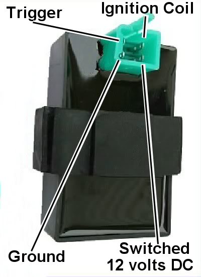

A four pin CDI looks like this:
Here is a five pin CDI:
Ignition switches also have four prongs. What are the colors of the wires on this mystery connector?
By "getting fire" when touching the solenoid posts, do you mean the starter motor is turning? Or do you actually have spark? To test spark you need to take out the spark plug, wire it back up and hold the plug threads against the engine block while cranking the starter and looking for spark jumping the plug gap.
I have never heard of your particular quad, and don't have a wiring diagram. However wiring between chinese quads is often similar, and with some tests using a meter and some logic we can figure your wiring out.
So the previous owner said it just needed some carburetor work. Is this guy your brother in law, or something? Why do you believe him? Buying quads in a non-running condition is a big red flag unless you know what you are doing. Even then it is a big risk.
But don't give up hope yet. See if you have spark.
While the plug is out do this test also: put your thumb over the spark plug hole and press hard. Crank the engine. Can you hold the pressure in, or does it force your thumb off with a "pop"?
Dribble in a 1/2 teaspoon of gas into the spark plug hole. Quickly reinstall the plug (use your fingers to start the plug threds before using a wrench), and try to start. Any signs of life?
