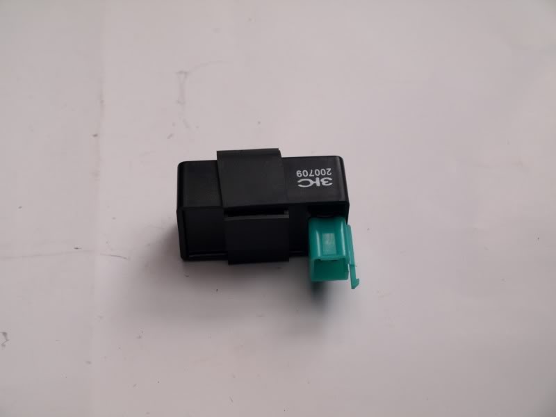

You can test the CDI by swapping from one machine to the other. If you have a good, strong spark, it's probably not the issue. However, if you would like to give it a try, your looking for this .....

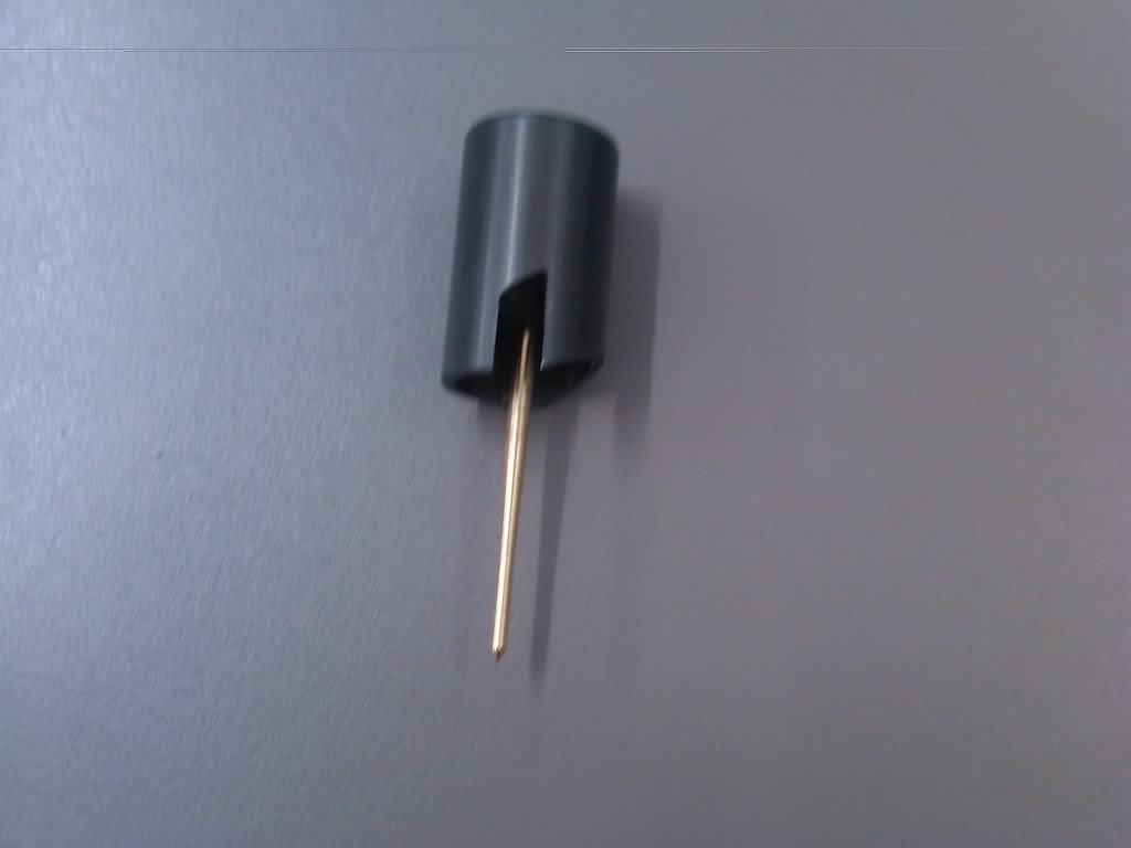

Great, hope it works out. Just make sure when you reinstall the carb, the notch in the picture below is in line with the idle speed screw. If you reverse it, or it doesn't drop in correctly, the machine will start at wide open throttle. You should feel it drop in a fair distance, not hover near the top. Depress the throttle a few times afterwards to make sure it doesn't feel like it's binding. Good luck !!
