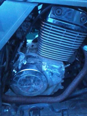

attached is a pic of the motor, just so you guys get an idea of it... It's very similar to a Honda Rebel twin cyl. style 250. Also attached is a pic of the type of carbs, They're similar to this set up. I borrowed the pic from google since I don't have a pic of my carbs at the moment.
