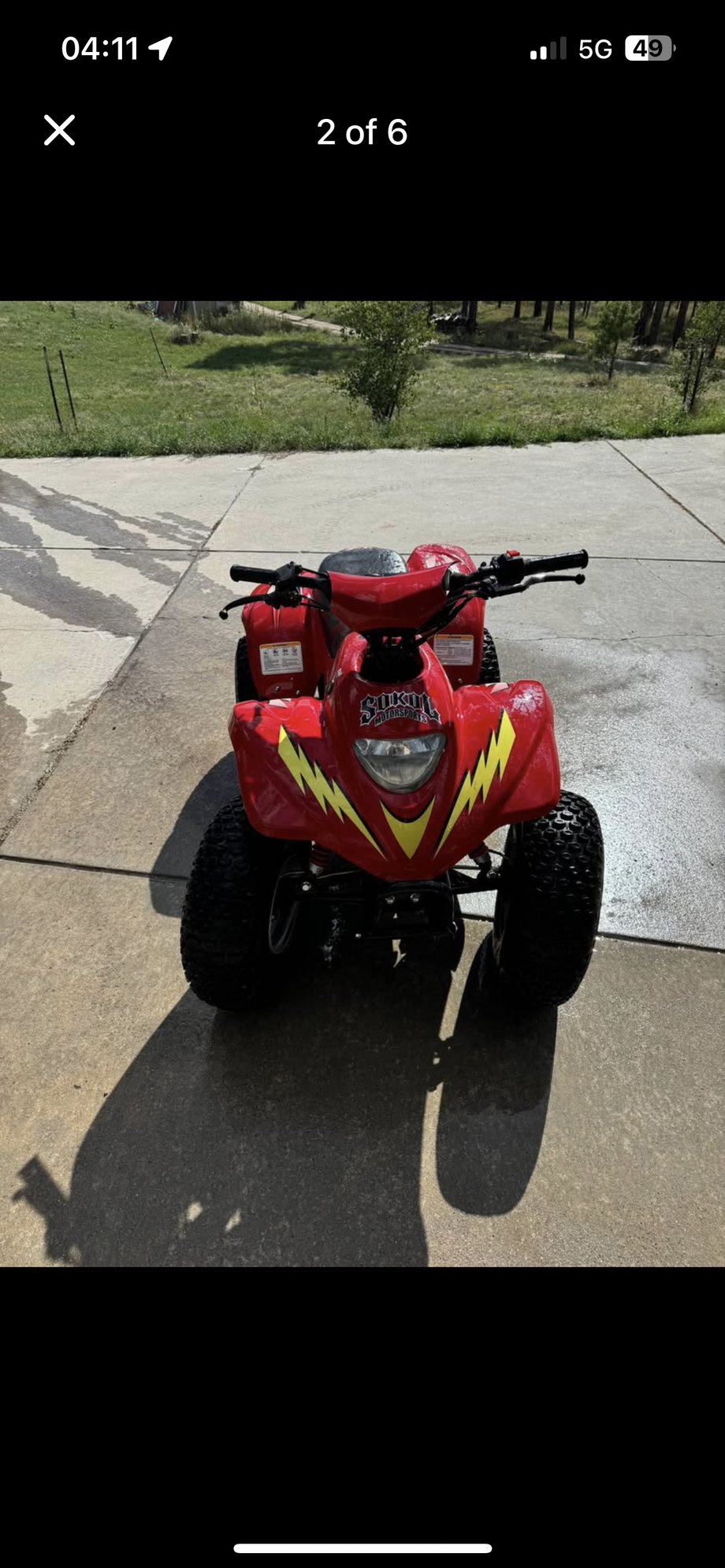

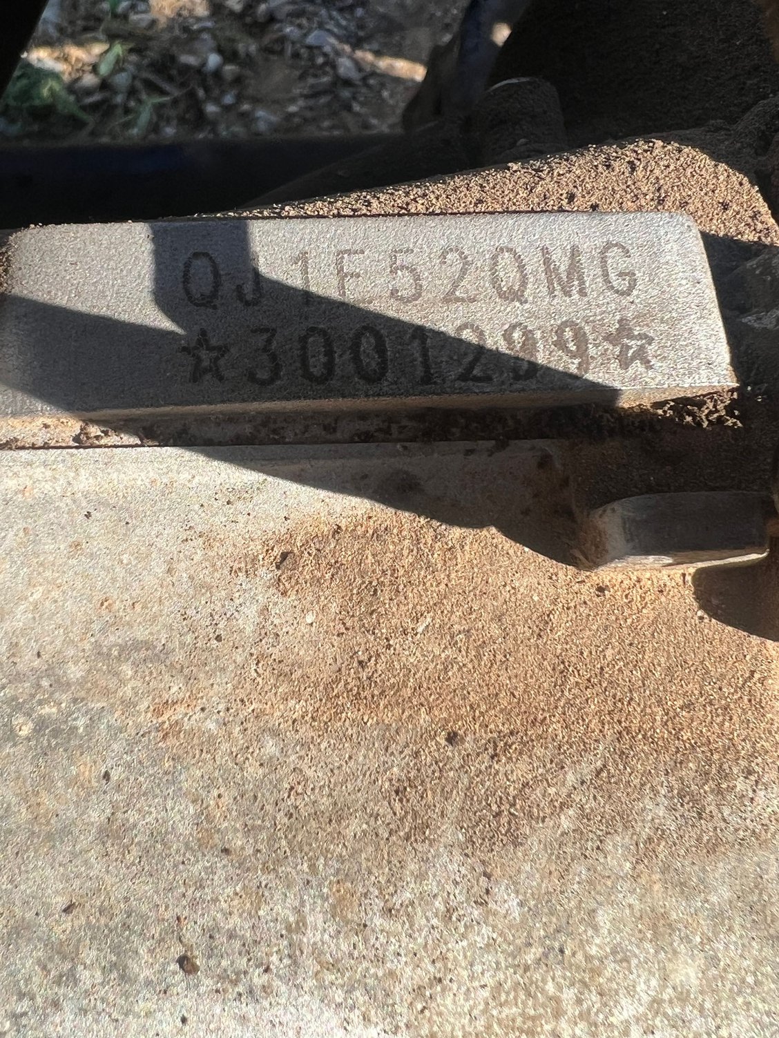

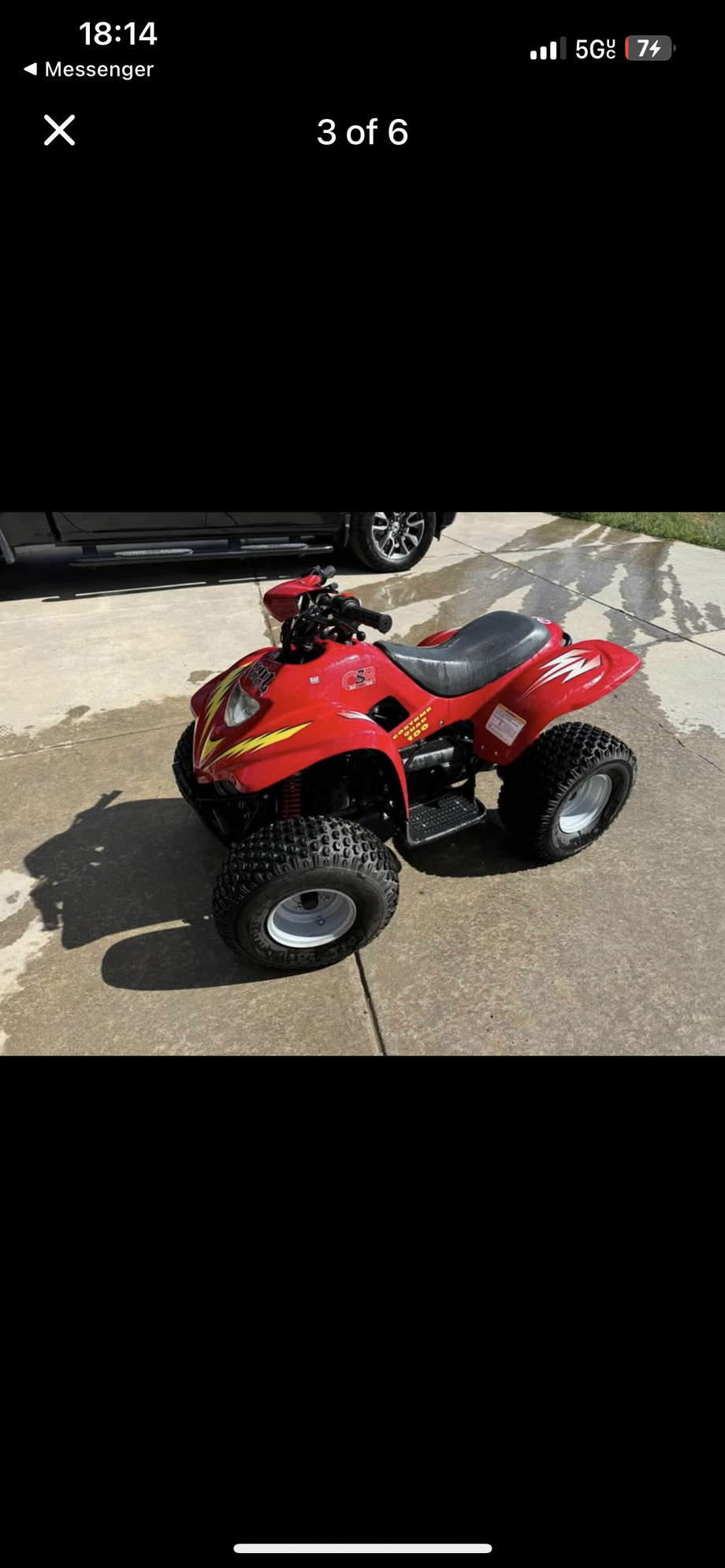

Hey guys so I have a Chinese 100cc kids quad I’m trying to identify so I can get the right parts for it I need a new wiring harness carb etc. I think I’ve got the carb figured out though. Anyway it’s an extreme commando 100cc 2 stroke with the electric choke and automatic oilier system. I know it has a QJ motor on it based of the number but I can’t find any QJ parts Any info on where to get parts and what manufacturer and model to look up would be great thanks I’ll post pics

Looks tidy, I think the engine will be the two stroke Minarelli clone, used in many bikes a few years back including the Polaris two stroke 90 and more recently Apache 100s. Why try to fit a new loom? Universals rarely fit that well and, as I regularly state here, if you know enough about electrics to fit a new loom, you know enough to fix the one you have, unless it has been on fire, or butchered by an idiot. If you can find the VIN tag it may have the actual Chinese maker's name, or the VIN number may contain the code for the maker.

Hey thanks for the reply it’s not as tidy now my 7yr has been running it pretty hard lately lol
I was thinking it was that engine but I’m new to quads so I’m trying to learn as I go. Here’s my thinking with the loom and a little about the issues I’m having. 1 the wiring on these are a mess. None of my wiring seems to be color coded and it seems pretty slapped together so I’m pretty sure someone has messed with it before. 2 every time it rains or the quad gets wet it starts running like hammered sh*t if it will even fire. 3 if I redo the loom I can color code everything plus I’ll know what parts are on it for sure next time. I.e stator, cdi, resistor etc. I’ve ordered a few parts that I thought were right and when they come in they don’t work or I have to play with the wiring etc to make them work.
