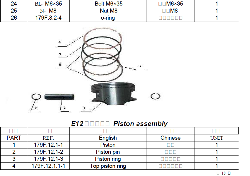

Piston - 79mm, UTV, Odes, 400cc
Hope can be helpful to Other members
