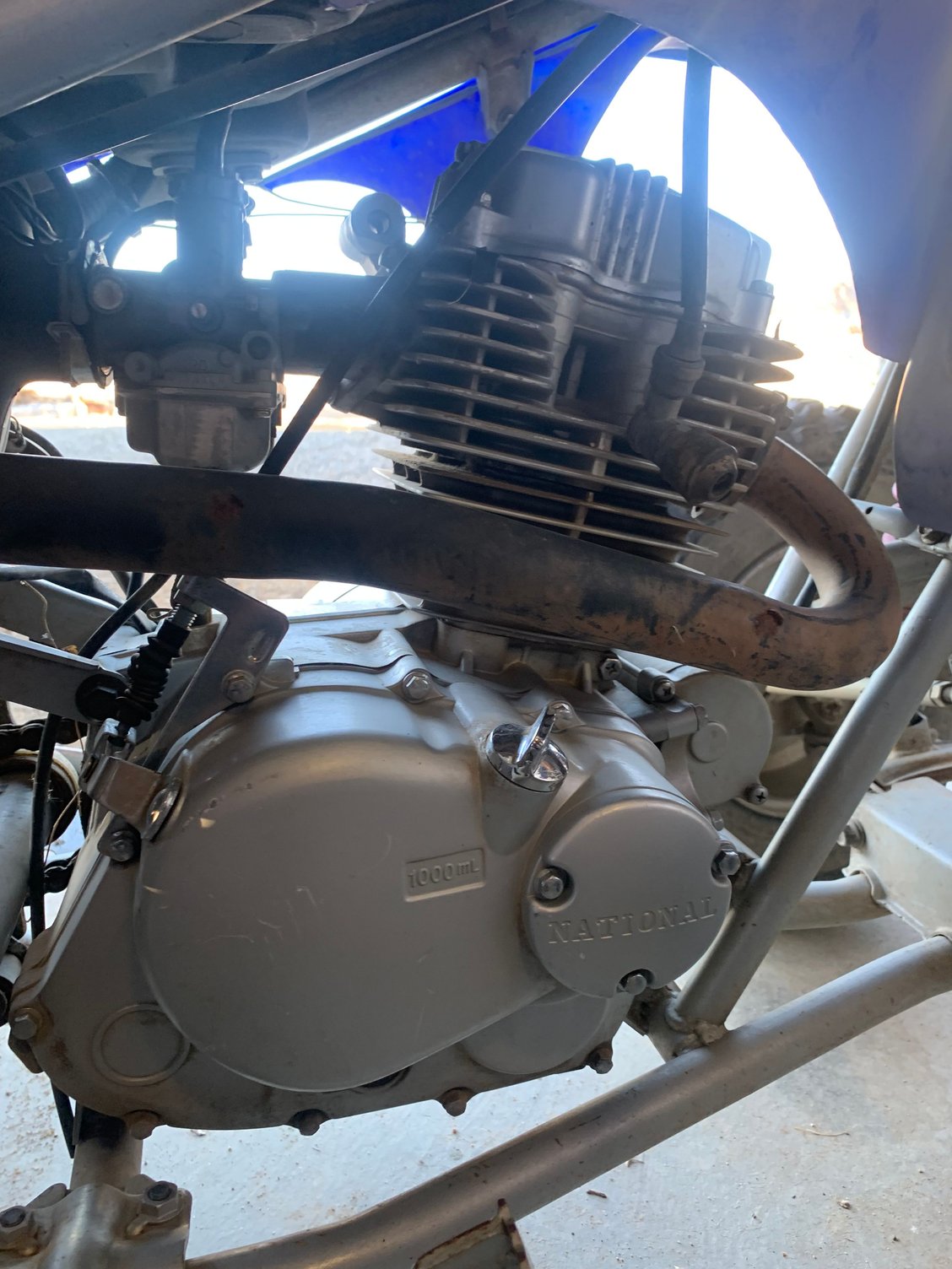

Put a couple of pictures up of both sides of the engine. Four strokes are almost always either a GY6 or a Honda clone, but the makers do mix and match a bit, using Honda 175cc or 200cc engines sleeved down or 125s bored and stroked, to give 150cc

Engine Number NM637232

I don't know small Honda models well enough to tell but it looks a lot like one. If it is a pushrod engine it almost certainly will be, as Honda went off overhead cams for their commuter bikes as they found the cam journals wore fast if owners didn't change the oil regularly. Loncin also copy Hondas and their CG150 is pretty close, but has the starter motor behind the cylinder. Can Baja themselves not help, they must have sold the machine originally?
