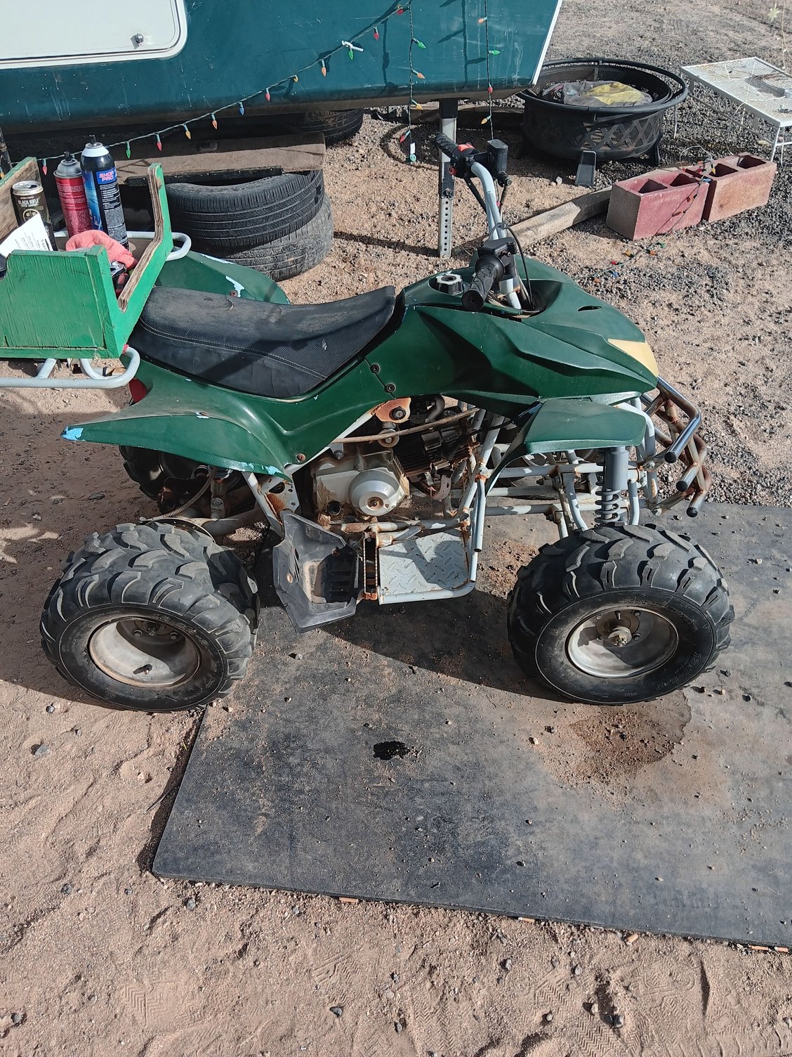

I Just joined and i need help identifying my quad cause it was a gift from my grandfather and he could not remember what make and model it was.

Those front shock mountings are fairly unusual, seems to have two alternative top mountings. Otherwise, the standard plastics and Honda Cub clone engine are used by many makers. Pity someone painted the plastics, it never sticks to the soft plastic used on ATVs, for long.

Thank you for the information it greatly appreciated can you tell what size motor it might be.

The engine number prefix is coded, with the bore included in the code, i,e, 157 means single cylinder 57mm bore, this doesn't pin it down exactly as Chinese makers mix and match bores and strokes. However I'm fairly sure the capacity is also cast into the cast iron cylinder too. That engine is made in sizes from 50cc to 150cc.
