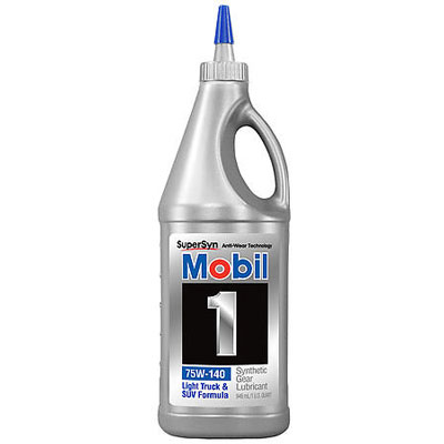

Actually we understand this is a very common issue stemming from the factory fluid’s tendency to rapidly expand when heated (which then weeps through the bellows).
Extending the vent hose is a logical solution if you find the venting fluid is making contact with your rear brake. A more permanent solution we’ve discovered is to replace the factory differential fluid with Mobil 1 synthetic 75w-140 gear lube. Making the switch resolved our weeping issues entirely.
