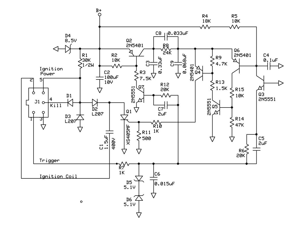

I actually took one of these 5 pin CDI's and carved off the epoxy and traced out the internals a while back. I did the same thing with one of the 150cc/250cc style CDI's with the 2 pin and 4 pin connectors. The wiring connections and components between the two were so nearly identical (other than the connectors) they were obvious copies of one another. One of these days I will post the schematic(s). I still have to convert it to jpeg format and upload it to photobucket. Anyway I see nothing in the schematic that would prevent the CDI from firing with only 30 VAC coming in.

I'm betting 95% that your CDI is bad. Your symptoms match a shorted C1 or Q1 in the following schematic:
This schematic is generated from a 5 pin CDI that I chiseled off the epoxy and traced out the circuitry just because I was curious. I bought it on eBay for around $12.
