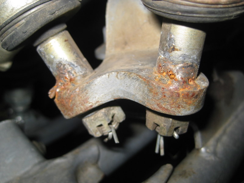

Yes the washers didn't stand up, I was refering to them little rubber holders for relays and what not. So far they are intact.... for how long I don't know.
As for your inner tie rods. One day I just went ahead and spot welded them on! No more issues so far and that was last spring. The kids put quite a few miles on it this summer. Its just the inner ones that give grief I've found. I thought of machining up something pretty ... but this works too. I didn't put a lot of weld on incase I need to replace them one day.
