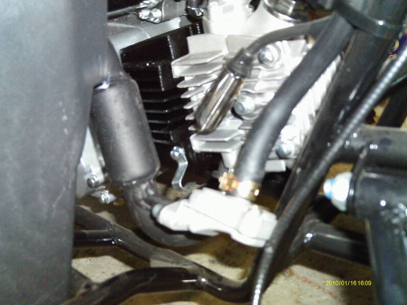

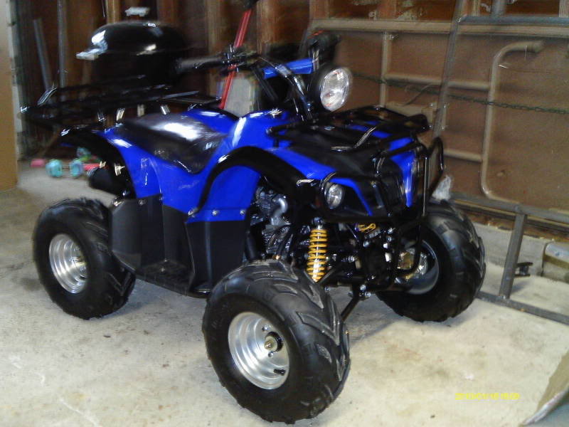

Some pics as assembled. Note how the right side footwell has to be completely removed to check/add/change oil and the "California" emissions package.

I'll have to do just that eventually. Being cold out, I really don't want to mess with the plastics too much. I've already put a small crack in the corner of the left side foot well. So far it looks like a decent kids machine for the money, but gross oversights like NO access to the engine oil is ridiculous. No wonder why they don't show you how to access or do anything in the 'manual' that comes with it. I haven't even put gas in it yet since I want to put a fuel filter and shut-off between the tank and carb. Only challenge there will be the short length I'm dealing w/ and the fact you need to allow gravity to feed the bowl.

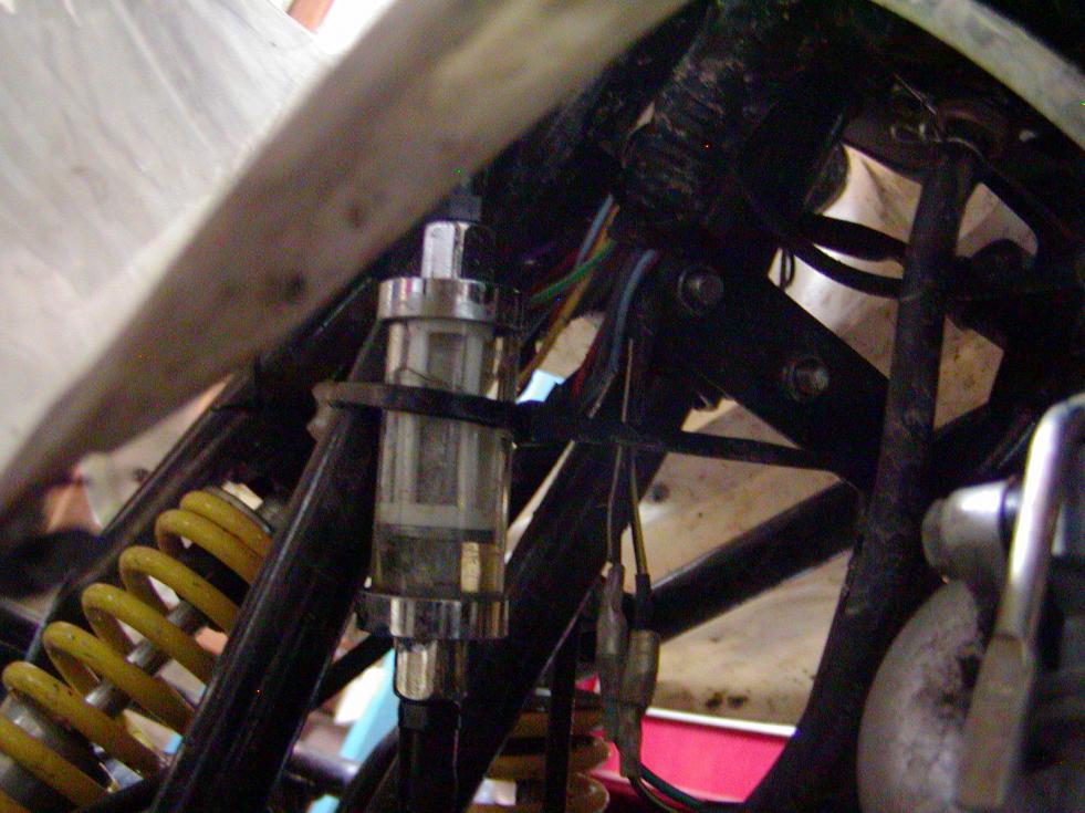

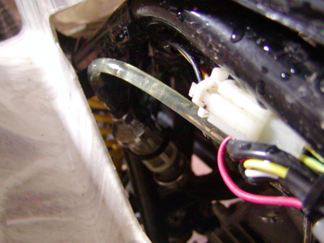

Hi OneTenCC I got the Tao Tao ATA 110-B. So far this thing has been a lot of fun; for him riding and for me fixing. I am a tinkerer at hart so it's all good. Here's what we've seen so far.
First there is a screen in the fuel tank so I guess Tao Tao figgures you don't need a filter. I put one on anyway. Got it from Wally World's boat department, the glass one with replaceable element. That way you have an inspection point for trash and water. I've been using them on outboard motors for years. You might as well get some fuel line since that little peace between the tank and carb isn't long enough to mount the filter without putting a kink in the hose. I zip tied the filter to the frame with the inlet at the bottom so it would work as kind of a water seperator. As long as it's below the carb it should siphon good. I did have to prime it but have been running it for weeks now with no problems.

Anyway sorry for being so long winded I just thought I'd pass on my experiences. It seems to me your taken this quad with the right frame of mind fun for the kid and tinker. Here's some pics of the filter.

From: West Falls NY
Good stuff Nick, thanks! You have to love Wally-world's automotive, outdoor and marine isles for this stuff. I rarely can walk out of there w/ out buying oil, filters and automotive stuff. I'm hoping to have the room to zip-tie a plastic shut-off valve along with an inline filter in there. I'll get at that this week. I did blue Loctite some of the nuts/bolts so far- the ones I had to touch for assembly. If it would stay above freezing for a while, I'll go at it again.

Yep. I hear you. Only issue is, the engine oil fill cap is in a spot such that I'd have to blow through the left inside lower corner of the foot-well. I'm thinking that's just going to weaken the hell out of the already crappy plastic!?!?
