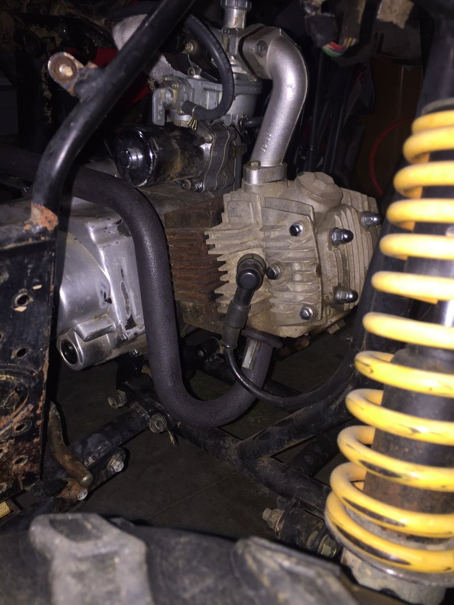

Biggest current concern which is why I am starting this post is the fact that the engine seems to really get thrown around when I try to open her up at all really. Like i mentioned before the rear mount bolt was busted and I did replaced that.. But is that really the ONLY place the engine mounts to the frame?? I see on the Jug of the motor that there is a threaded hole on either side of it. Is there some lower mount I am missing? I googled and tried looking at stock china 110 quads but could not tell from the pictures.. Nor can find any kind of engine mount parts on the sites. If it didnt shaked so much as to throw the chain off I wouldnt be concerned. It wont do it at idle even revving it. Only with shake the engine when it is in gear.

Pictures of engine in front.. Notice theres nothing holding the engine anywhere to the frame. Last picture is rear engine mount bolt I fixed up, just putting this here in case it may be missing a bushing or something? Not sure, just was hoping these would help someone help me diagnose.Spam wordSpam word

Do yourself a favor and grab the owner manual (this should answer some of your questions):
http://www.atvsnetweb.net/asset/manu...nersManual.pdf
Near the end it clearly shows 4 mounting bolts on the bottom of the engine...guessing that's your problem...
