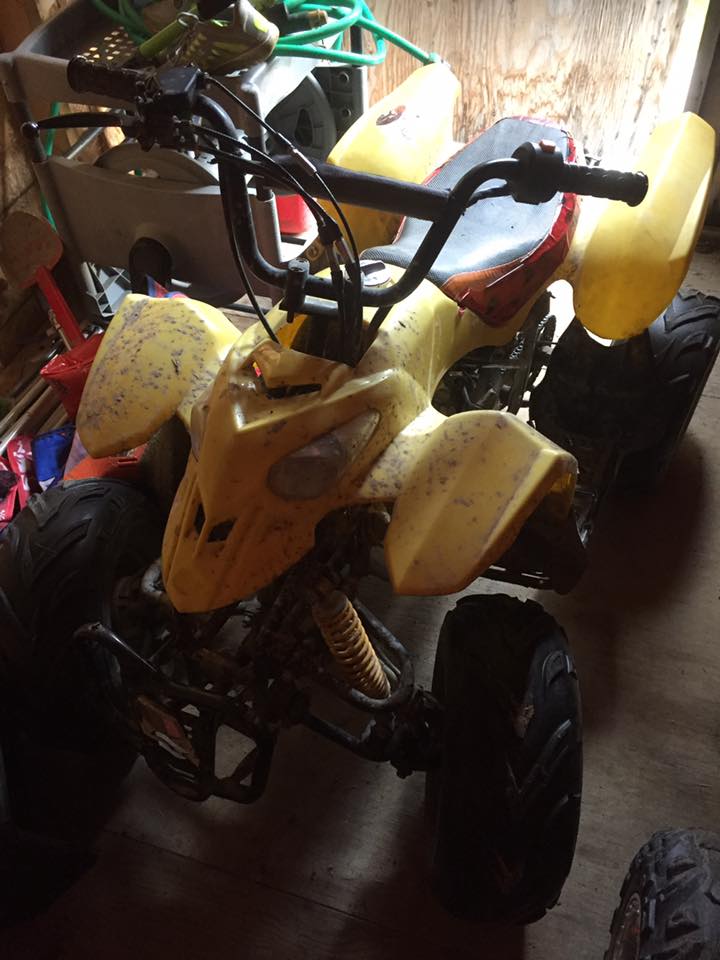

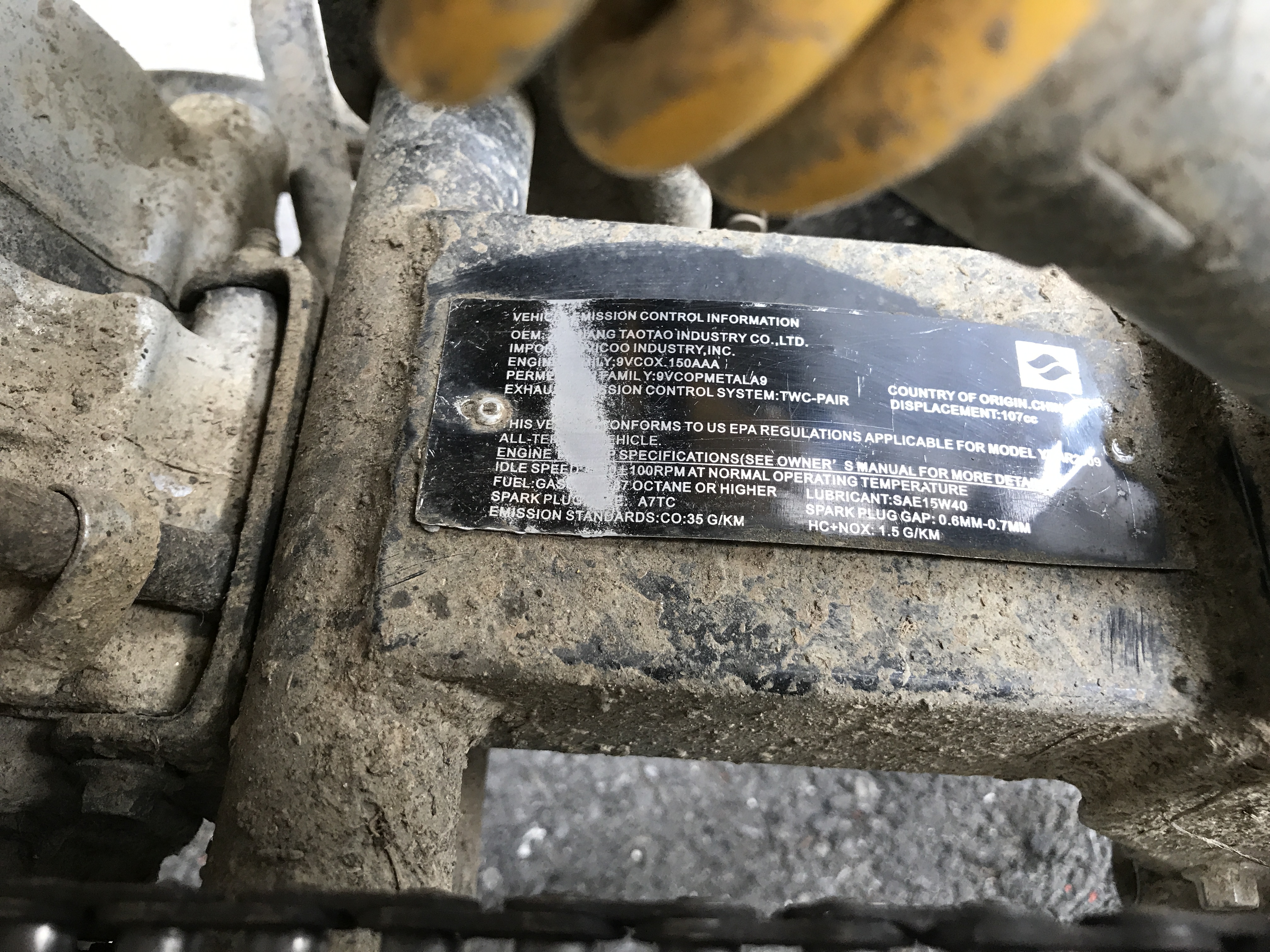

I just purchased a old quad for my son. the only information that I can find on the bike itself is a black sticker that states the year 2009 (i have attached the photo) and its a taotao. Looking around on the website it looks like one of the ATA 110L/L1 , Tonga 110 Big Wheel (110-7 BI) but on that sticker it shows 107cc.
I am a bit confused and need to order some parts to get it working safely for my son. Any help would be greatly appreciated.

107cc will be the true capacity of the cylinder, such descriptions as 110, 125 etc, are rounding up to the "class" of capacity. As engines get bigger, the difference can get very marked, I think the Honda Recon "250" is actually about 227cc.

Ok thanks for that so it's a taotao 110. Does that mean any parts for the 110 would work or do I need to find the module number of this specific bike?
would it be s two or four stroke? How would I know for sure?

It's a 4 stroke. All parts should be easy to get.
