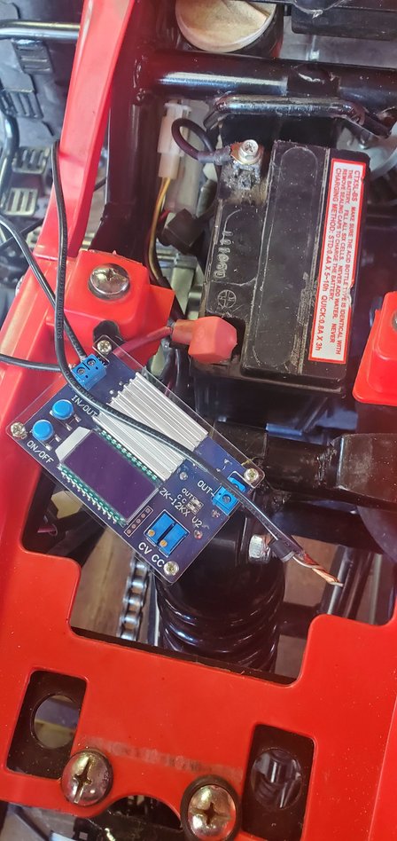

Default I solved the problem of overcharging
Originally Posted by stanferd98
bought this from the net for Christmas last year for grandkids, it has cooked 3 batteries. Under warranty sent stator and reg....didn't help 2 regulators later still over charging. at idle 13 volts has idle goes up peaked at 17.8 volts...unplug regulator stops charging. any help would be Appreciated
It looks like the rectifier does not regulate the voltage only converts from ac to dc. So I bought a regulator from Amazon and wired it. Now the voltage won't go past 14 volts. I'm gonna put the links and pics. Let me know if you got any questions. FYI
Input negative is from the chassis
The output negative on the regulator is not connected.
Amazon Amazon
Cut the red wore exiting the regulator. Connect the input positive on the regulator to the red wire exiting the rectifier. Connect the output positive to other end of the red wire you vut
