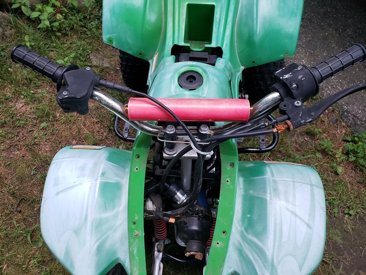

I got this for free, know nothing about it and while it's in pretty good shape it does have its issues.

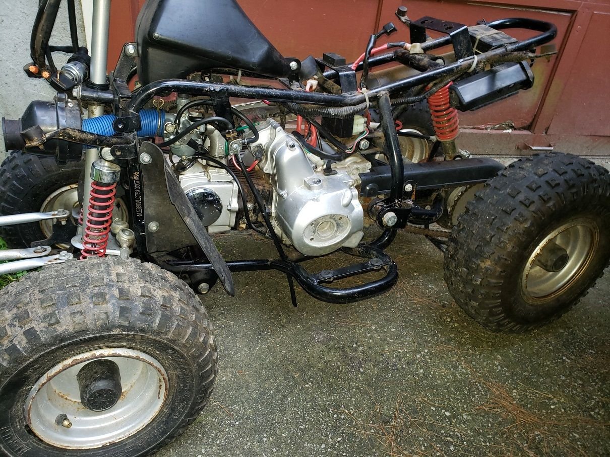

1) this is a 2 stroke right? I see no oil filter or crankcase except the transmission one.
2) if 2 stroke, what's the proper mix of gas/oil for this?
2) How do you put it in neutral? for whatever reason when I start it the transmission is already engaged in drive and wheels spin.
3) Could someone identify another name for this that I might be better off searching online? edge 50 comes up with nothing I need the seat, rear light and few minor things.
4) is there something missing from the front right handlebar or no? it looks like there may have been another lever, but there's no front brake or cut pull wires so maybe it's just the way it should be.
5) Any way to easily identify the carb? I cleaned this one and it's running little rough still, it's a "mitsumi" or something like that but model I can't tell...

It will be a rev and go 4 stroke. Engine is a copy of a Honda 50 motorcycle, but I think those did have gears. Engine and transmission run in the same oil. I can just about make out the vin number and it comes up as being made by Guangzhou Panyu Huanan Motors Group Co., Ltd. but in 2001 rather than 06. Some bikes have two brake levers, some haven't. Carb will be a close copy of the ones used by Honda, which, I guess, would be a Mikuni.
They usually have a lawnmower style centrifugal clutch so, when you rev them up, the clutch shoes fly out, grip the clutch drum and off you go. So engine has to idle slow enough for the shoes not to be gripping the drum. Brake usually has to be applied when starting so you don't suddenly set off.
