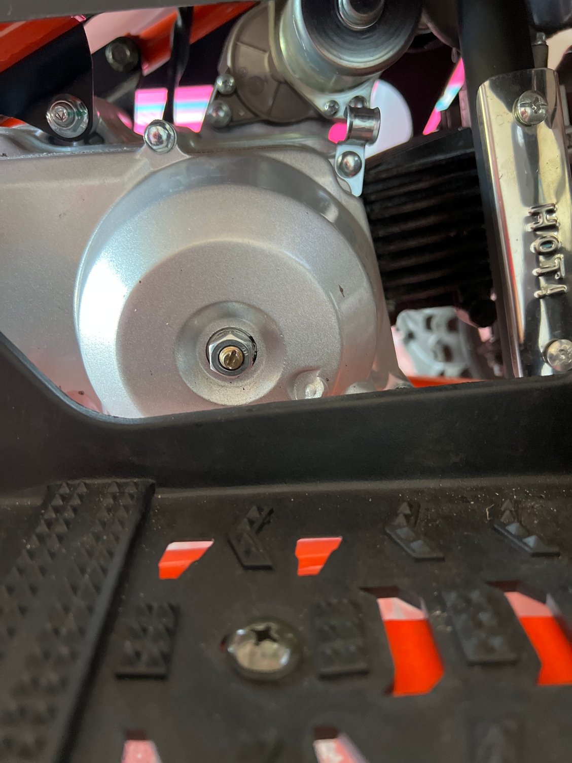

Old Mar 6, 2022 | 10:10 AM
  #20
mike G's Avatar
Joined: Mar 2022
Default Kayo fox 70 no low end power
First be sure like everyone else is saying that the throttle is not limited still, there’s a small screw you can back out for more throttle, turn it in for less. My personal kayo fox 70 (2021) I adjusted the clutch on the right side of the motor with a 14 mm open end wrench and a flat head screw driver. Be sure to warm the bike up completely and that the quad is off during each adjustment. Loosen the nut on the right side of the s crank case that has the flat head screw in the middle of it while keeping the flat head screw driver pressed against it. Back it out half a turn and press the screwdriver inward toward the motor also backing the screw out….being sure it doesn’t turn and tighten the nut back up. Start it up, try it. If it’s there’s still no gain try another half turn. In the end I was almost 2 full turns. I cannot tell you how far you can turn it before it just completely comes unscrewed so do it at your own risk. Our quad takes right off now but you don’t want to over do it. If your quad is lurching forward while it’s idling there’s a good chance you need to loosen it up a little bit. Hope this helps anyone.
The nut is in the center of the photo, there is a flat head screw in the middle of it. The screw is actually what holds the nut against the case, not the other way around.
