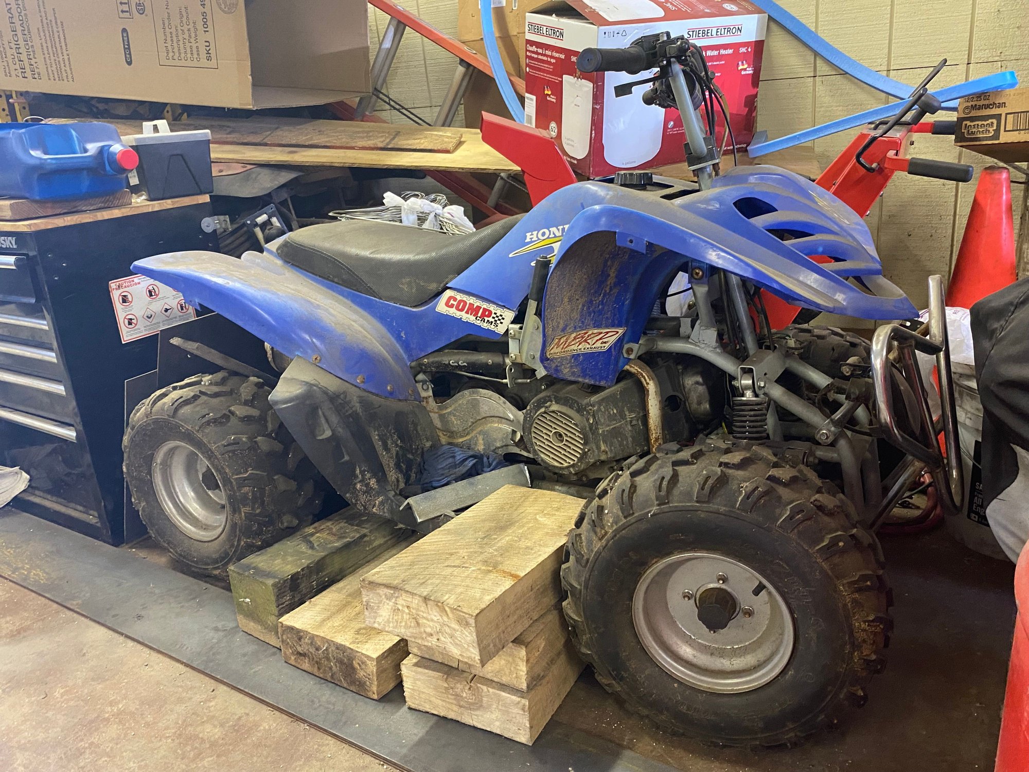

Hello,
I am new to ATVConnection, and hopefully I don't do anything wrong. I have this ATV that my stepfather's brother gave me, and I wanted to fix it up for a little event my family is going to, the problem is, I really do not know who made it, it has Honda stickers, but the VIN does not register, so I am guessing that the stickers were placed on their for some reason since I checked the VIN to see if it was stolen, and thankfully it was not stolen. Can someone please help me find out who made this ATV? The VIN is: L5NATNAA77T
000558
Old May 20, 2022 | 02:00 AM
Posts: 7,486
Likes: 387
According to Cyclepedia's decoder
2007 Jinyun County Xiangyuan Industry Co.
This will probably have been sold under a name dreamed up by the importer and has a GY6 engine, which was mostly used on circa 150cc machines as the Minarelli 2 stroke and 4 stroke Honda Cub clones were more popular for smaller bikes, and clones of bigger Honda engines were/are used on many 200cc and up models.
Old May 20, 2022 | 06:36 AM
TheFerret's Avatar
Joined: May 2022
oh, that's interesting, glad to finally find out the actual name of this ATV. Thanks a lot merryman!
