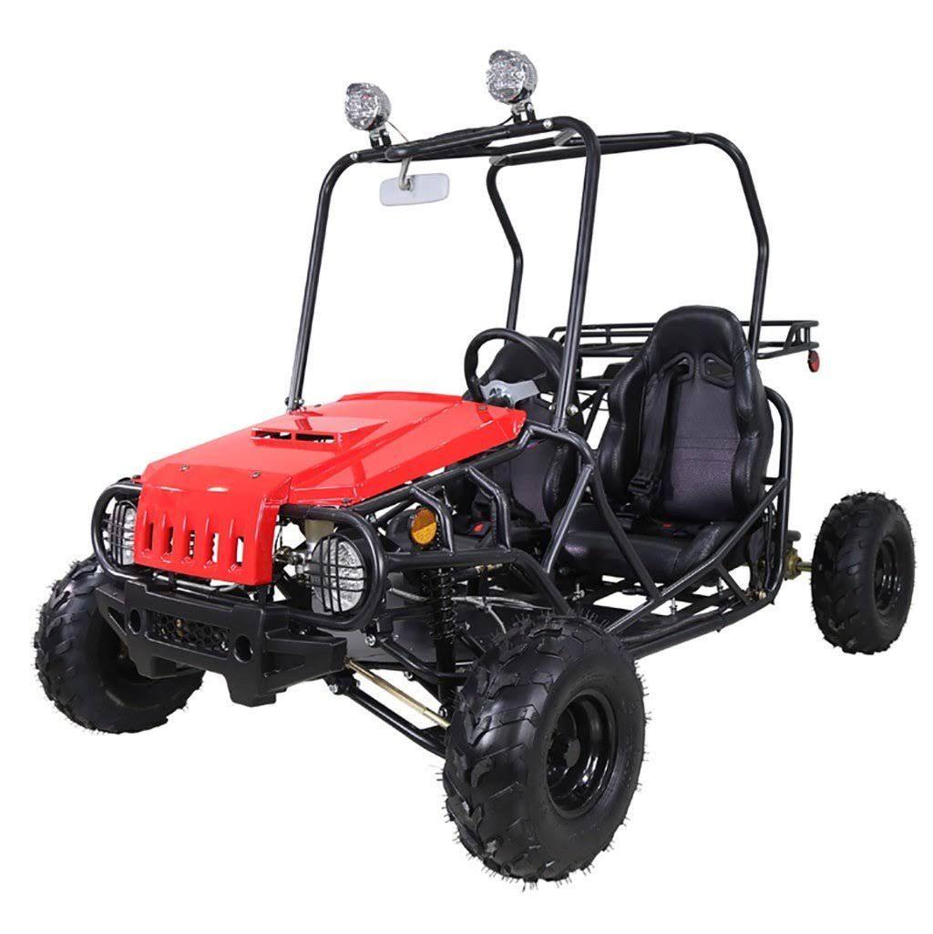

Good morning, I’m new here and joined to hopefully get a handle on on what’s going on with my new to me Tao Tao Go Kart. My brother bought this new for his daughters, he followed the break in procedure and switched over to mobil 1 after the 1st oil change. He’s always run VP non Ethenol fuel as well. When I got it from him it started kinda hard and he mentioned it has always been a bit cold blooded so I didn’t think much of it. As my son and I tried to use it though it wasn’t running right. I had to modulate the choke, and it would occasionally stall when changing from N-R or N-D. I figured it was a carb/fuel issue so I asked my small engine guy down the street to take a look. He ordered an adjustable carb for it(identical in spec to the original but adjustable), put a new plug in it and now it starts and runs beautifully EXCEPT..
1. It idles super high, so high that you really dont want to shift it into gear: we start it in gear with the ebrake on.
2. If you adjust the idle down to a normal +/- idle speed it stalls when you try to put it in gear.
3. It now smokes? He (my small engine guy) didn’t put any time on the motor maybe 15-20 minutes around the yard. It didn’t smoke before but now it has a solid haze and often thicker
most of the time.
What have you experienced with these engines? Thanks in advance for your help!
