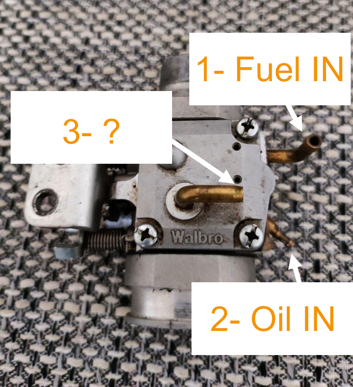

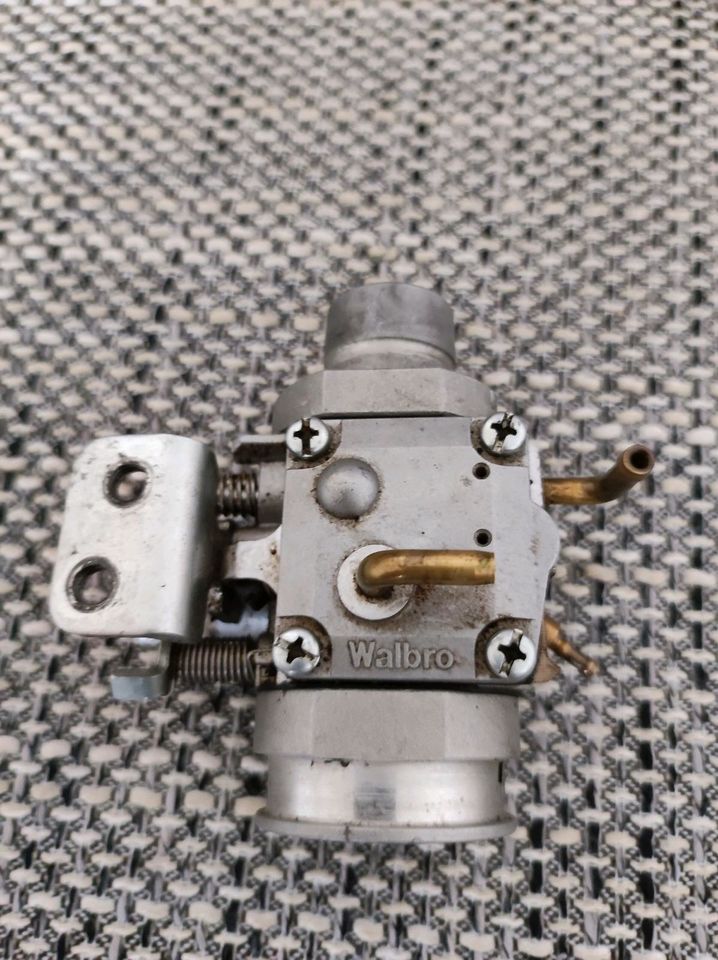

Hi,
Excuse me, I'm French.
I found a DINLI DL601 50cc Quad in a barn.
The carburetor hoses were disconnected and/or missing, and I cannot find any assembly diagram for the WALBRO WJ98 carburetor...
On the carburetor there are 3 connections, a fuel inlet, an oil inlet, and a 3rd location (this one gives me a problem, I can't find any correspondence or connection for a hose... is it simply a venting ?)
Thank you so much !
Old Apr 1, 2024 | 02:46 AM
Posts: 7,511
Likes: 391
Diaphragm pump carbs continually pump fuel from the tank, any excess that is not used by the jets, is pumped back into the tank, so you need a pickup pipe from the bottom of the tank and a return pipe to near the top of the tank. An oil pipe on a diaphragm pump carb is unusual, but some two stroke engines pump oil into the carb or manifold, rather than using pre-mixed fuel in the fuel tank.
Old Apr 1, 2024 | 10:54 AM
gouna's Avatar
Joined: Mar 2024
Thanks, I'll go see if I can find an entry on the tank
