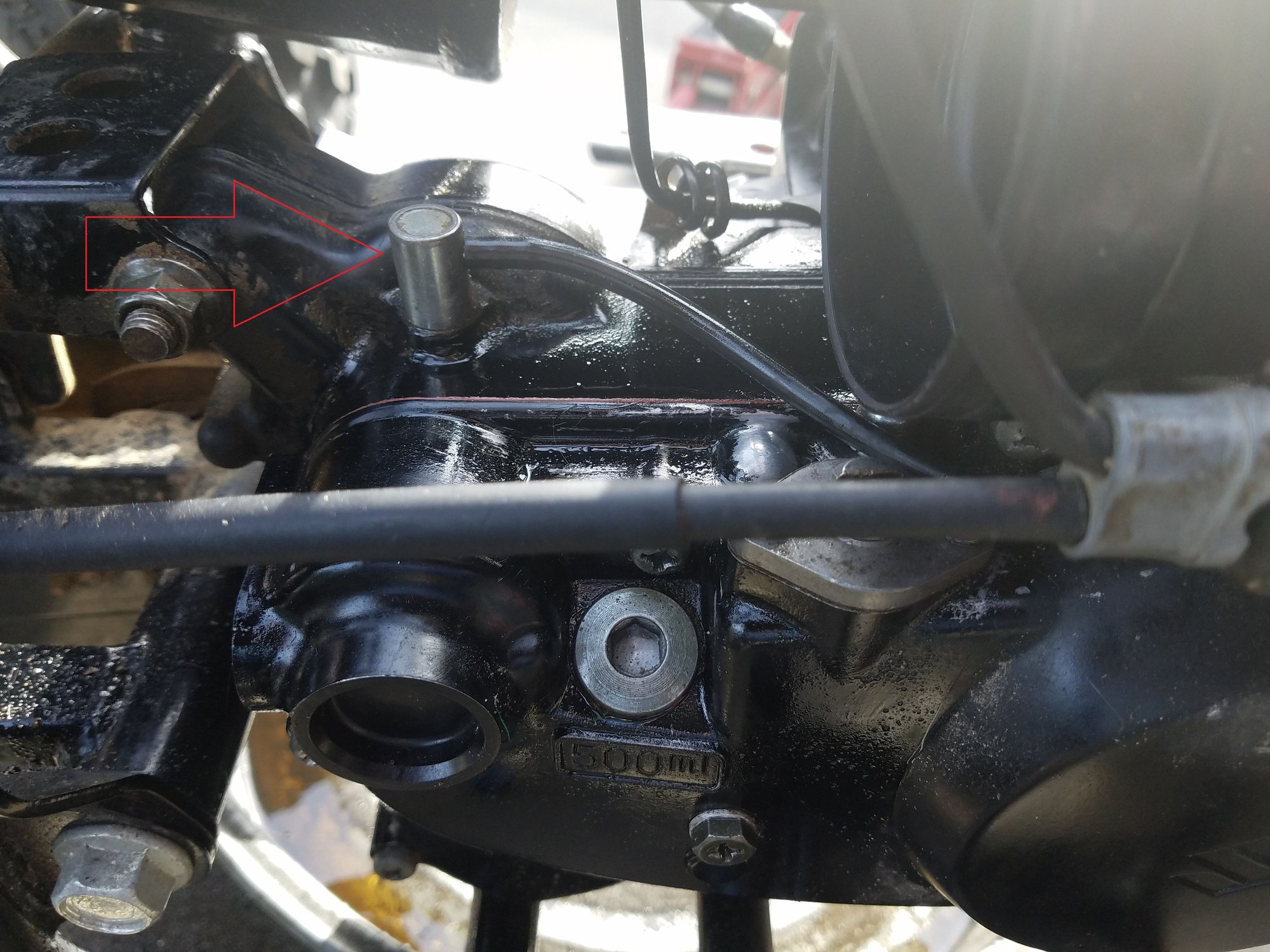

The hose coming out of the indicated breather vent hose spews gas when the quad is at high RPMs. Anyone know why? How do i fix it?

Fairly sure that is the gearbox breather, so for fuel to be getting in there, the crankcase oil seal must be leaking. Never taken one to pieces myself.
That's what I feared was happening... Crap
