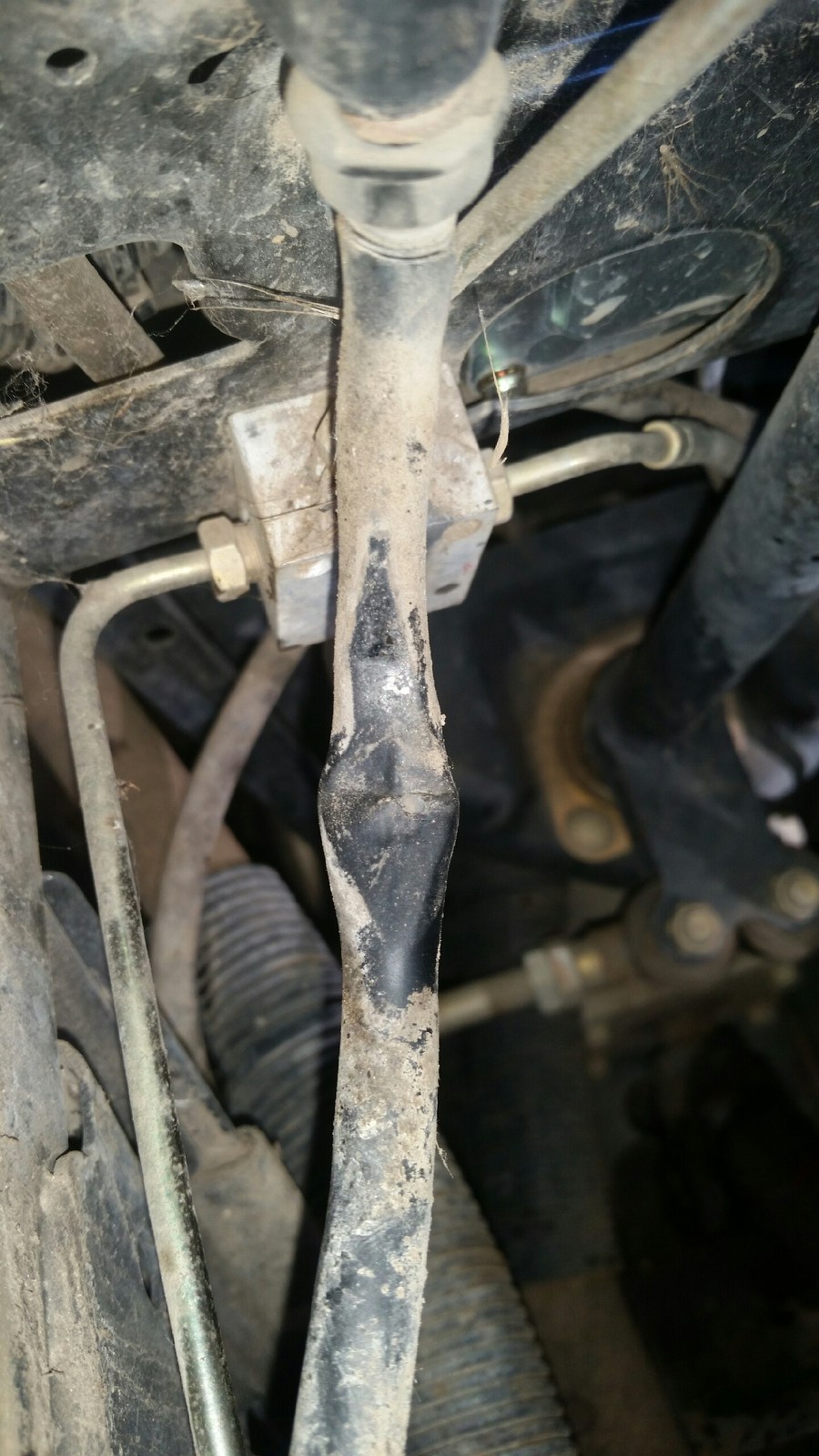

Thumbs up Spark Plug Wire
This might be the problem. This is the left spark plug wire. It has been pinched in between the gas tank and frame. I have a new one ordered and it should be here by the end of the week. Let pray this fixes my issue.

Old Oct 12, 2016 | 12:53 PM
Had the same thing on either the 2004 or 2005 model 500s that had the same problem from the factory.. Polaris wanted me to pull the coil,but I just replaced the 7mm plug wire..
