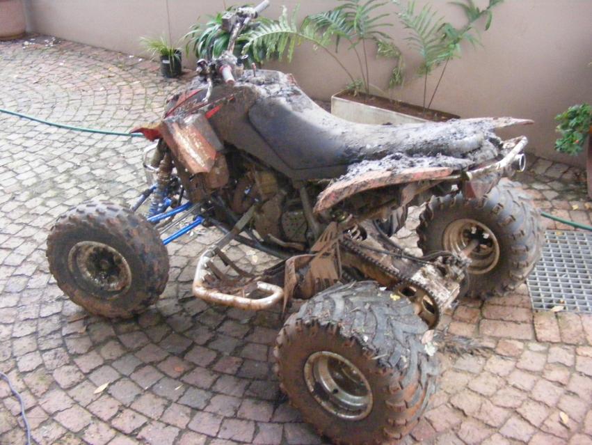

Personally, spacers don't do well on front as they throw the geometry out on steering pivot point. Good if you want to look cool, not practical. Go wider A arms and work from there.
Extended rear axle is better and safer option too. But you would know this, I'm sure.
Wider set up sucks on some trails, I've a DVX with Gforce rear axle and PEP front gear. Always in and out of the ruts. Really tiring but looks awsomely cool!!!!!!!
What's the price of a broken limb again?
