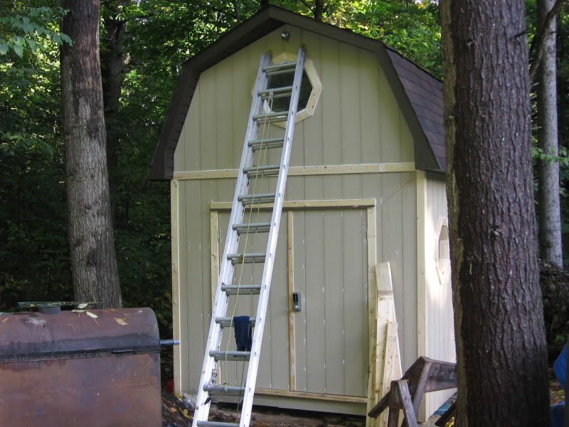

In my shed, built only to store my ATV, I simply painted the floor 3/4" OSB (small shed
9'x12' to avoid building permits) I simply painted the foor with 3 coats of garage floor paint and where tires roll and contact floor, I stapled carpet squares all along to protect the floor. My tires are heavily studded for snow removal and off trail riding. Works for me. Here are some photos. Still have to paint the siding roughly same color and all wooden trims on the outside will be painted same chocolate color as the soffit.
