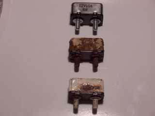

More than likely the main circuit breaker finally bit the dust.It provides electrical power to the dash,ignition,lights,starter,left control switch. They're designed to kick off if there's a problem and kick back on. It's in a sealed pouch up from the battery,usually tucked under the fender area on the frame. Check that it has voltage on each side of the red wire. If it doesn't slice the pouch open and check connections. Even being sealed up they can corrode from moisture and heat and short out.Cheap to replace at any auto store.Install the new 20 amp breaker and squeeze a little silicone in the pouch and tape it up. Here's a new one compared to a couple that are trash.
Attached Thumbnails 2001 Polaris Expedition 425 odd electrical problem.-1000936wj9.jpg

I took a look at the breaker and it looks shiny and new. I also tested the voltage and both sides were flowing electricity.
Im not sure where to go from here.
