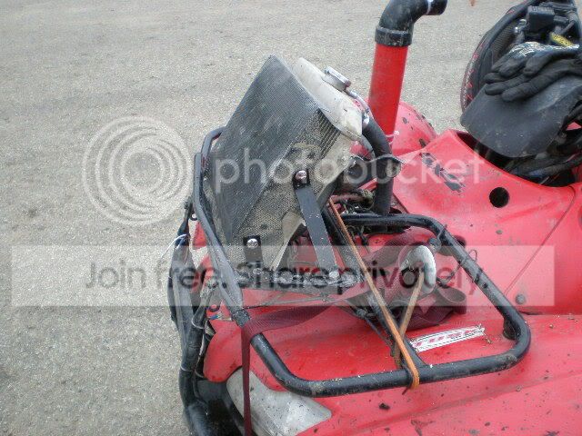

heres the pics. im not sure its going to stay there yet. it works good im just not sure if i like it there yet [img]i/expressions/face-icon-small-smile.gif[/img]
Old May 27, 2008 | 11:05 AM
wlvrn's Avatar
Joined: Feb 2007
Posts: 416
From: North Carolina
Default Honda Mechanic need help...
im thinking about making a platform to put on the front rack and then laying the radiator down so the fan is on top and using the resevoir to add the fluides. im not sure if that will work or not yet. any thoughts?
