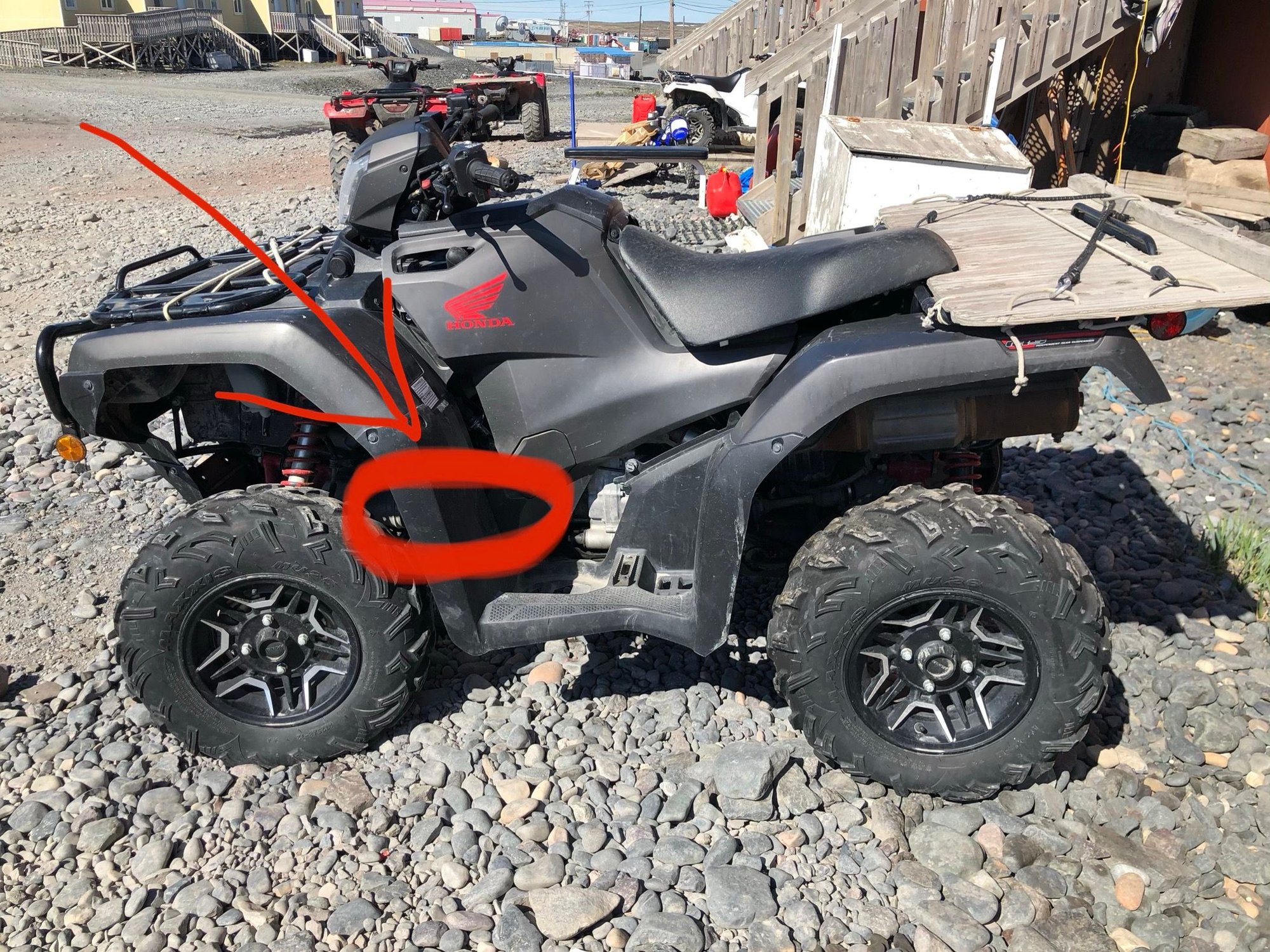

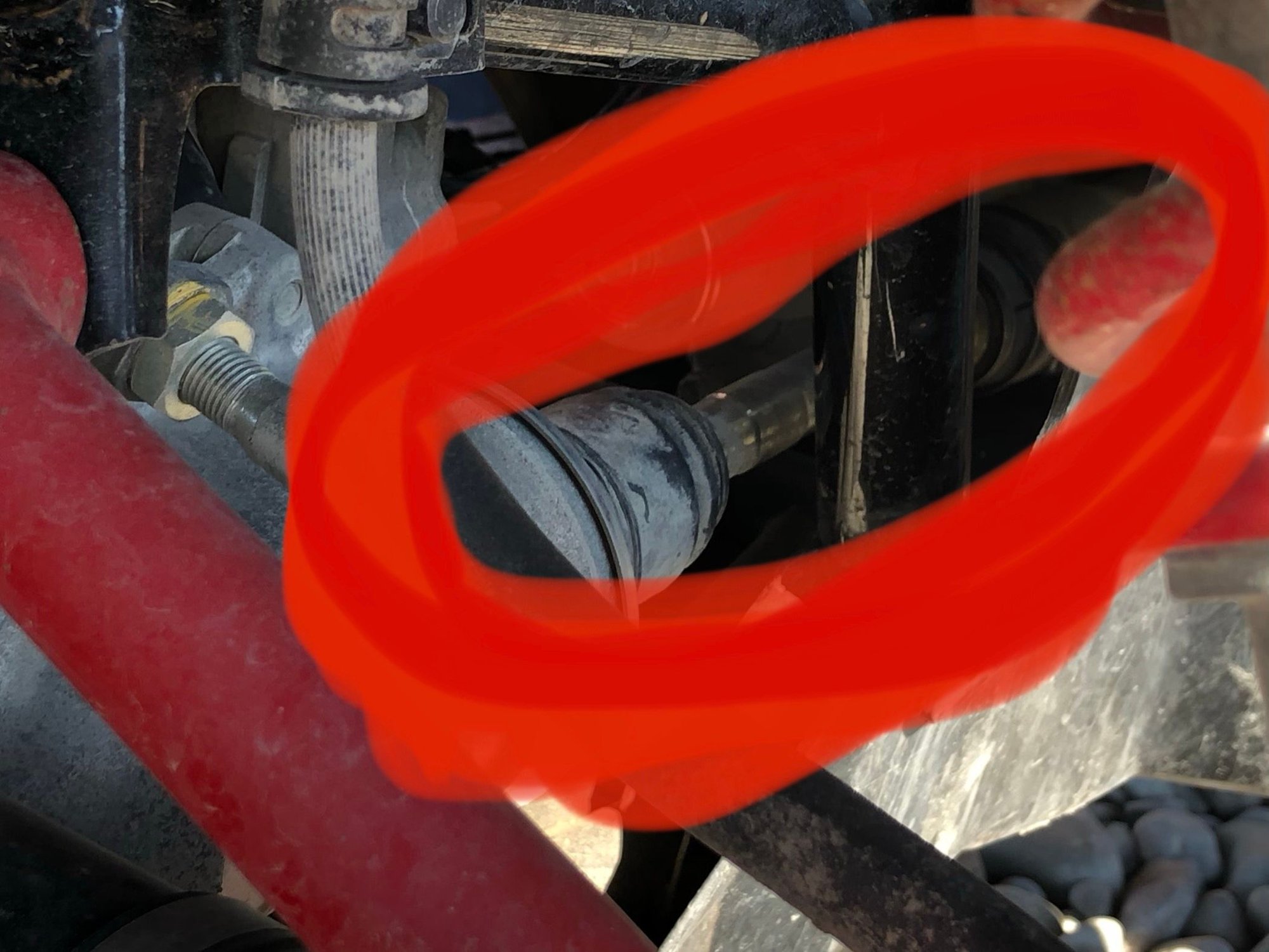

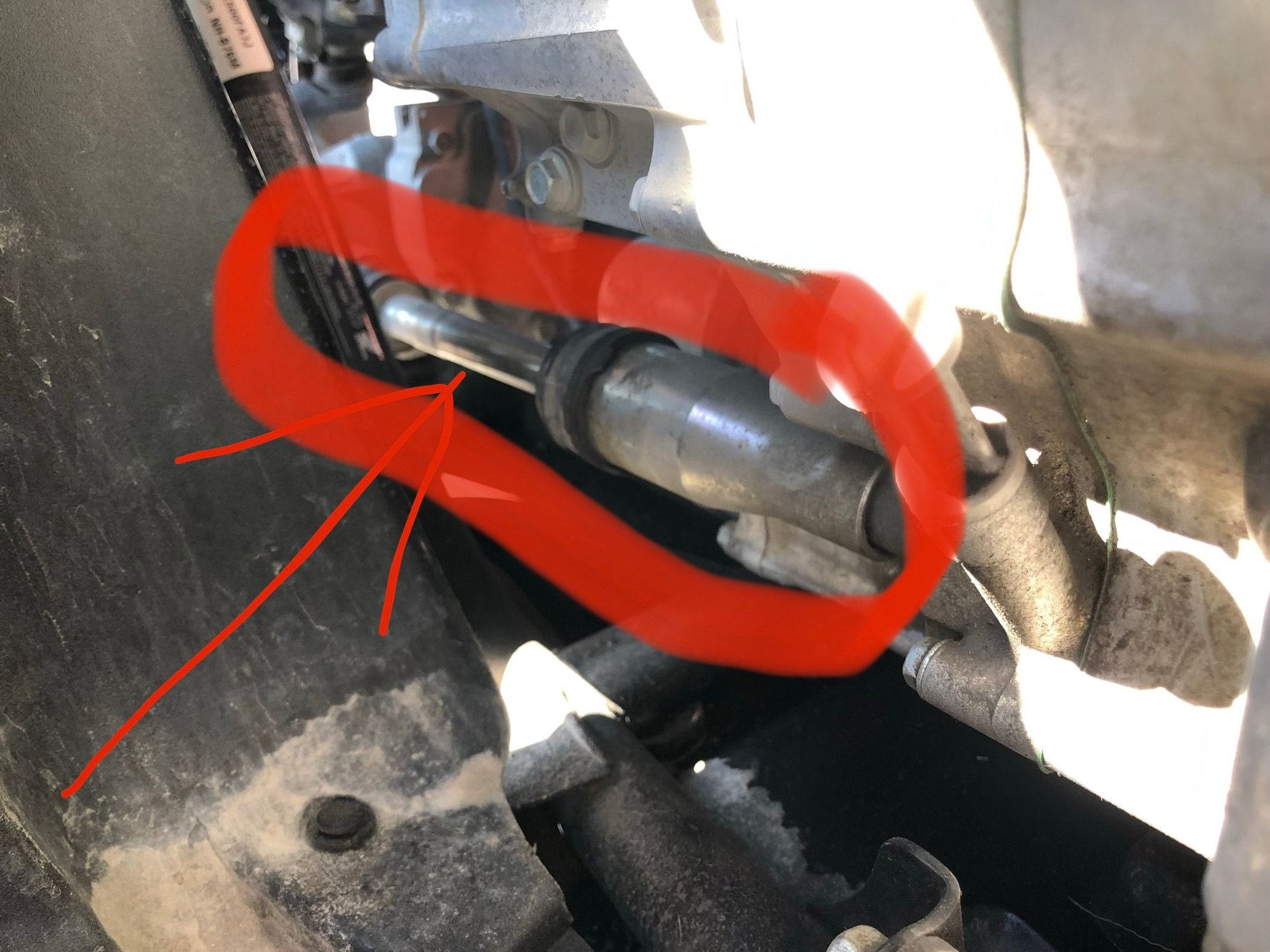

I can’t seem to find my atv part # the part that I’m looking for, my atv model i on the picture and I will show the part that I need on the picture also.
The part is circled
The part is circled
The part is circled
This is the pat that i need it’s in front left side of the atv

Front propeller shaft, available as a complete unit or individual parts https://www.hondapartshouse.com/oemp...ont-final-gear this is the parts drawing, any Honda dealer will be able to supply. Part number 40400-HR6-A61 The bit that fits into the diff is separate, so check that is OK. Not often they give trouble on a 2 year old bike, especially one with switchable 4WD, check all those O rings are sound, and slap plenty of grease on the splines, never had one let go yet that hadn't "dried out" due to a faulty O ring.
Just noticed it looks like 25" tyres on front and 26" on rear, if so, no wonder the shaft let go.
