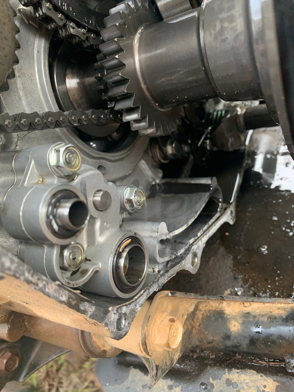

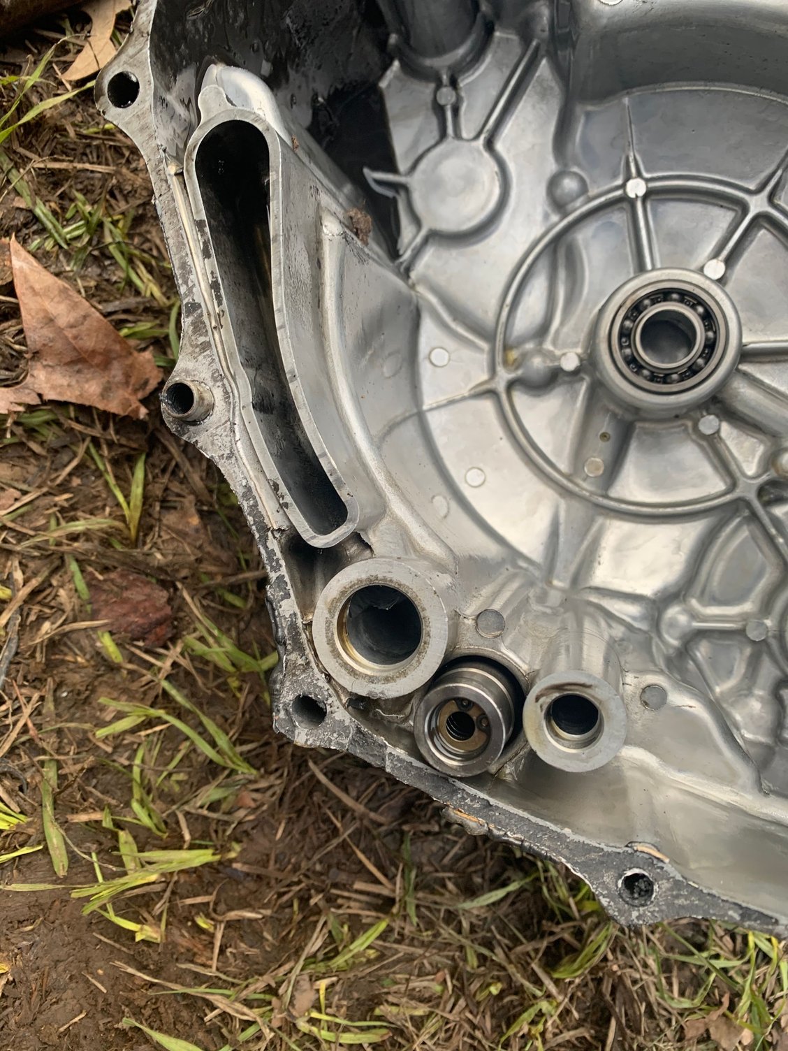

I attached some photos of the pump and case I don’t know what I’m looking at but I did turn the engine over with case off and the oil pump is turning

here some pictures I took today I don’t really know what to look at

I’ve tried to upload pictures to show you the oil pump and where the oil goes into the pump at but it will not let me keeps saying moderator has to approve the post and it been 2 days but anyways I’ve got the cover off I rechecked the oil pump to make sure it was moving when I crank engine over without spark plug in it moved the pump now I’m lost to what to check there so many holes on the engine case I can’t tell which is the oil holes
