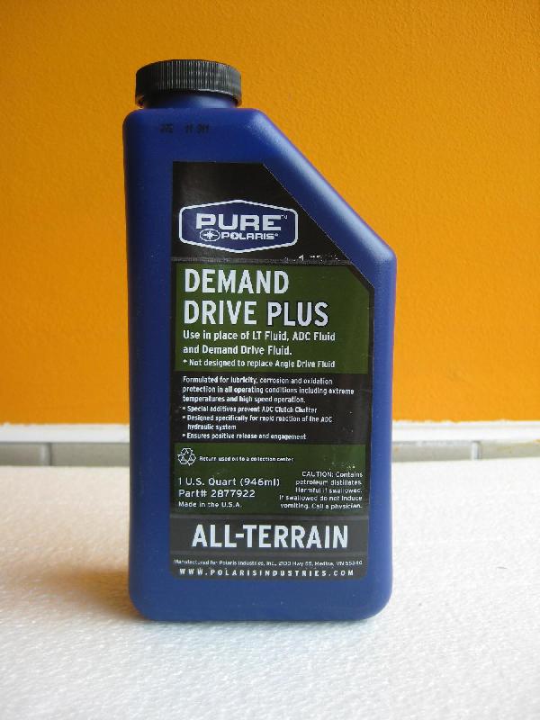

thanks. so I should agl fluid in the gear case for the sportsman 90 and angle drive fluid in the front differential of the sportsman 500 4x4?
No.. Use AGL for for the gear case on the 90,Demand Drive Plus Hub fluid for the front diff in the 2005 Sportsman 500.The Angle drive fluid was used in the older model front diffs that had the hub activated awd systems..Your model had the awd system in the front diff..
