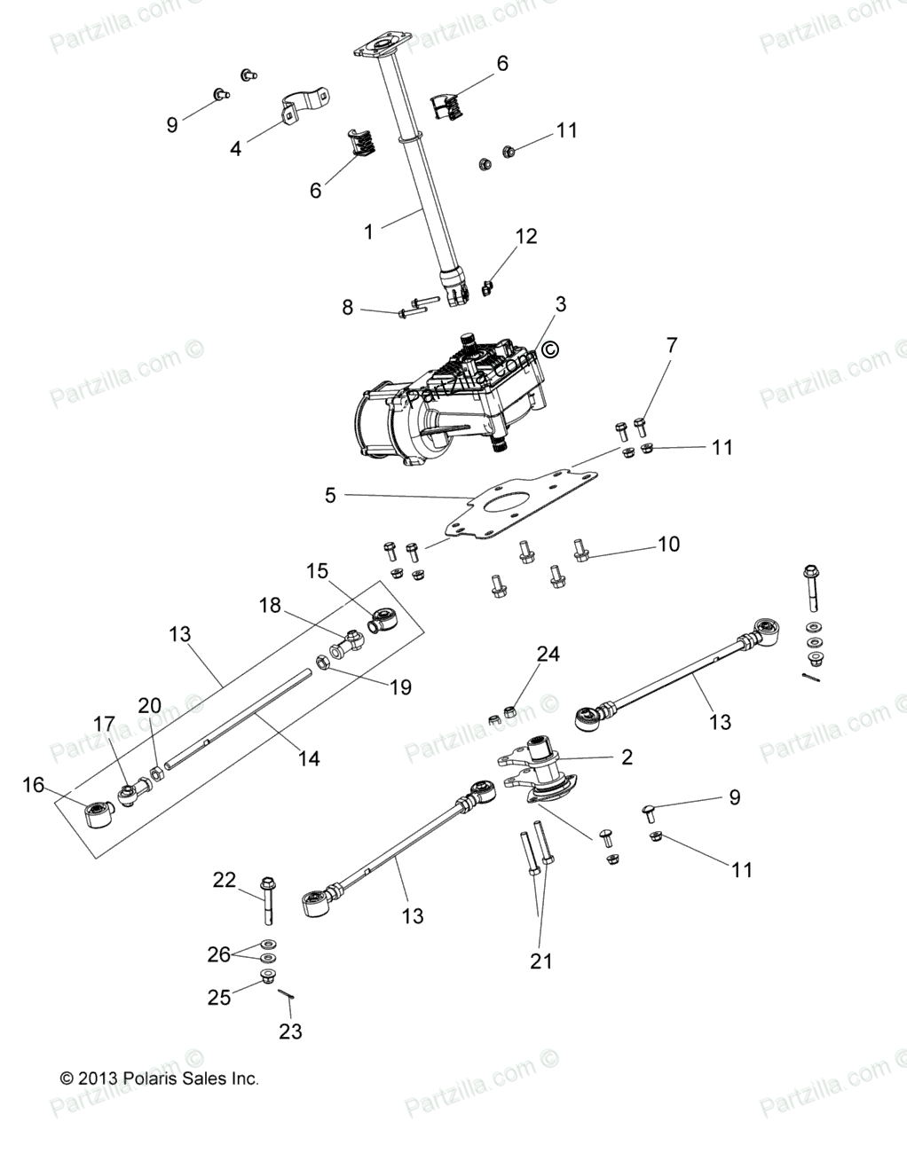

Welcome to the forums. You just bought a left leaning Democratic atv since it won't turn right.. If you're in a cold area,possible the power steering unit may be acting up a little. If possible get it in a warm place for a little while and see if you can free it up.Heard of some even using hair dryers on the power unit to warm it up. If ther's no visible tie rod or other damage as scootergptx mentioned,that's what I'd check out. Hopefully being this new, moisture or water hopefully isn't a problem. IF you have the 2 wheel drive version without eps it's a lot simpler to check out.
