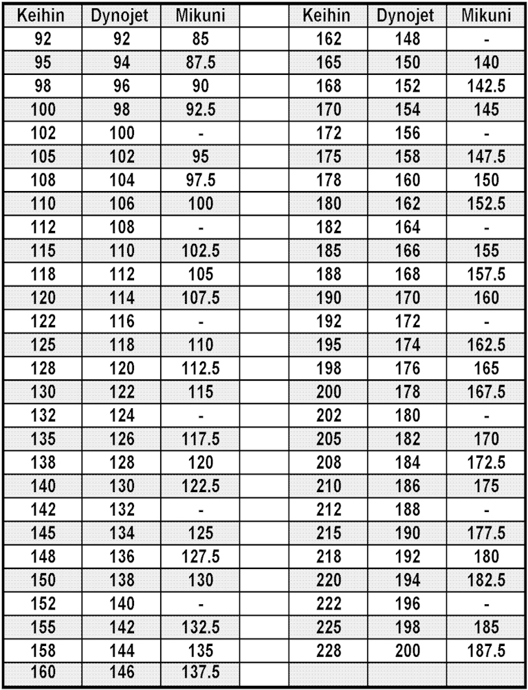

Try a Dynojet kit. I've used em on older Arctic Cats. The adjustable jet needle is nice. Or , if you know the jet size for the main jet, you can order a couple fatter ones from <jetsrus.com> Here is a chart, as Keihin, Mikuni and Dynojet numbers are a bit different. Why they didn't standardize, who knows?
Attached Thumbnails some not right around 35+ mph-jet_numbers_cross_reference_sheet.jpg
