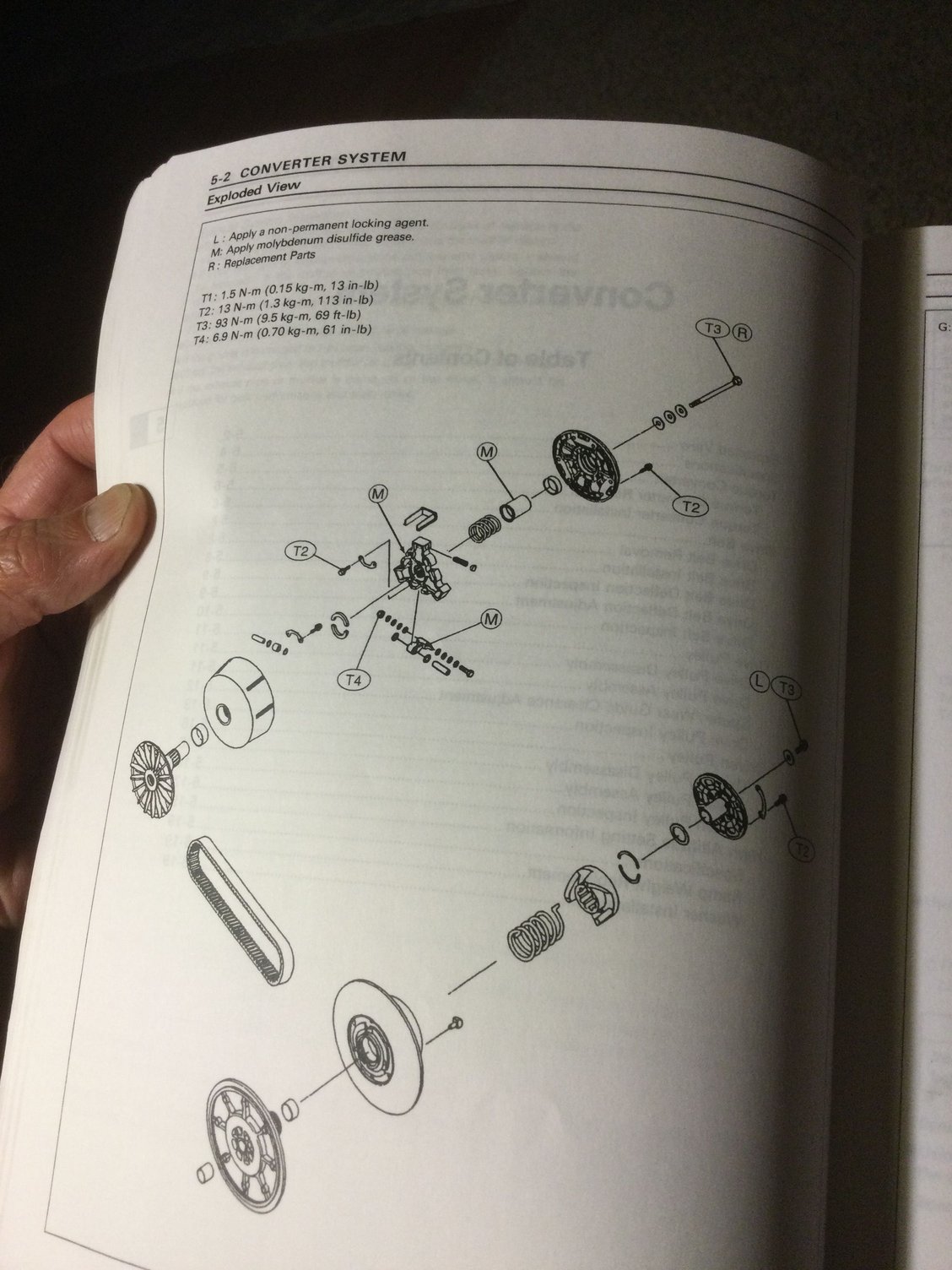

Well I learned something again. Been riding snowmobiles since 1992 and all of the clutches on those were meant to run dry on the skidoo and arctic cats I had.
I looked in the service manual for my 2000 400 4x4 and it does say to apply moly lube in a few spots.
