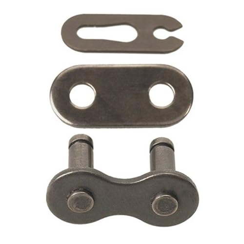

The rear brakes on my 200cc redcat do not work very well ... hardly at all... any suggestions?? Also the chain on it is very rusty but i cant seem to find a link that comes apart.. one has a little thing that pops off but i cant seem to break the chain apart.... i want to take it off and soak it in something to get the rust off.. how does it come apart?

For the chain...After you get the thing that pops off (master link clip) you need to pry the side plate off. Use a flat blade screw driver and pry against the link next to it and it should come off. Then you can pry the other side out and get the chain off.

ok cool thanks for that pic and the description .. yea i thought it was supposed to come apart there but i didnt want to mess anything up..its just a little stuck cause of the rust i guess.... and its only a 2006.. would bleeding the breaks help ?(if possible).. and i really didnt look at the pads ill have to check them out.. easy to replace?
