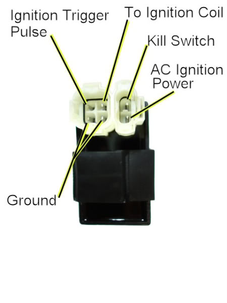

I haven't seen a hi-bird. Do you have a voltmeter? Wiring diagram? By chance does your CDI look like this (some other 250cc engines use these CDI's):
If your CDI looks like this then we can measure some things to narrow the possibilites down. Otherwise you *will* need a wiring diagram. Anyone else have one?
Report back if the CDI matches the pic and we'll go to the next step.
