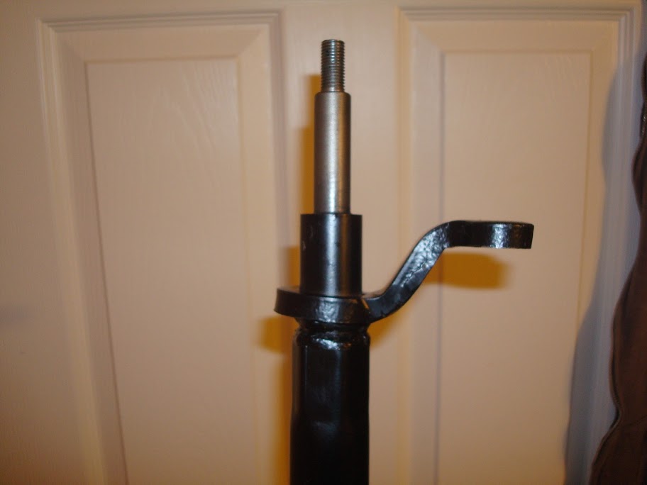

Also while riding it I noticed that it would turn sharper one way that the other so while the front fender was off I thought I would center the steering link between the stops and re adjust the tie rods to make the quad track straight. While doing this I noticed that the tie rod end nuts were hitting the frame before the arm was hitting the stop. Some how the person who welded the arm onto the steering shaft did not get it straight and it got welded on a angle so it need a new steering shaft to make it right. Have to call Tim tomorrow and see what he says.

Neal, I had the same issues on my V4S and my brother-inlaws V4S. Check outofline's web page, he has excellent photos for increasing the turning radius in both directions. My tie rod ends also hit the frame before touching the steering stops. I hacksawed the extra length of the tie rod off to clear the frame.
Outofline's fix for turning radius was to grind some steel off of both sides of the steering shaft stops. This worked great for the two V4S ATVs I did.

I called tim at V-Bike today, I think he is getting tired of hearing from me but he said that they have sold thousands of V4S quads and I am the only one who has had this problem. I sent the shaft to him for exchange, I hope the new one is welded on straight. I thought about making a new arm and replacing the one that's on the shaft but I thought I would take the chance that the new one would be better. I have been doing machine/tool and die work for 20+ years so I don't have a problem making most items.
