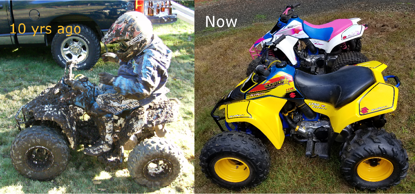

Hey Jack, happy you’re still sharing your knowledge .. thanks to you & the kind members here, I haven’t had to buy a manual yet and these old quads have hauled around a lot of kids .. been lusting over your engines for more than 10 yrs but my budget has usually been a hand full of rollers and a couple blue & black rattle cans. Just spiffed up these old quads a bit & splurged on some stickers for the grand-kids.
