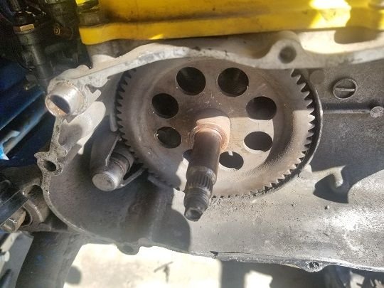

Just seen pic.. WOW.. Not supposed to be like that!!!!!
OK, Let's make communication a lil more used friendly. I'll tell you the name of the part and you call it that.
Rear clutch: part w/weld is the post/fixed face. The other is the sliding face. Only discs are those flat/thin/fiber things that went on the rear clutch hub.
Front: Front outer is the fixed face and the front hub that hold the rollers is the movable drive face. Most call it a variator tho.
THe variator is stuck. I'd bet the previous installer let the notch slip off the keyway thus pinching it when tightened. Pry it off as careful as possible. Fair guess you'll be getting most all those parts new.

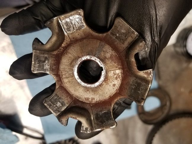

So as you can see in the first picture I posted I bent that back cover piece with a pry bar removing it.
Got the screws out that hold it on, had to shock them with a chisel and ruin them but they came out one last time. Grease is rock solid and came out in formed chunks and the rollers are flat spotted and overall destroyed. Above and beyond that you will see in the pictures. It is a horrible horrible mess.

It's just as I suspected. Prolly seen it 100 times.
Is the roller tracts in the variator gouged any?
