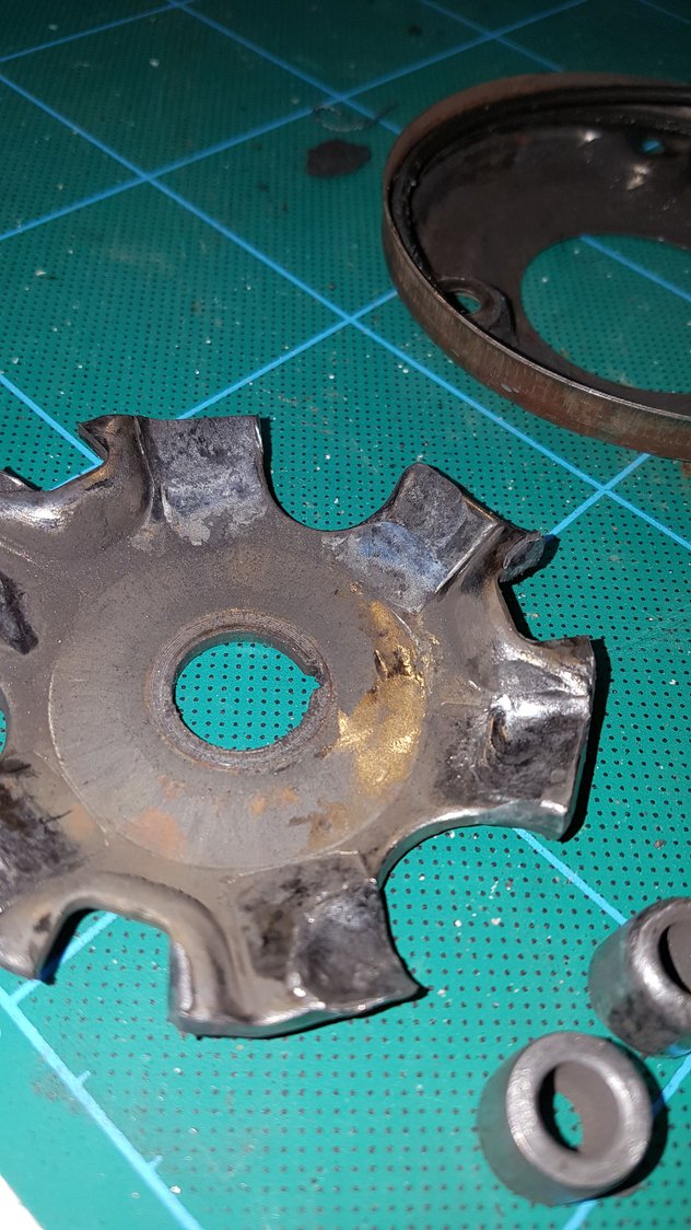

Evening just had my lads quad apart as the rear end locked up.... Always wondered why it only had one screw in the air box. Some how managed to get into the rear clutch after 2yrs of owning it..
How much slack should be in the belt?
Is it time for a new one ?

Belts wear forever. I highly doubt you need one.
As far as the slack, turn the rear clutch and get the belt up where it belongs.
Of course you know to service the clutchs while in there.

Front: You need to check the rollers for flat spots. If the grease got hard, there may be damage. Never know till in it. FYI: I only use a dab of grease and that's to hold the roller in place.
Rear: Make sure the bearings are good. Rough up the contact pads slightly to break the glaze. Squeeze the sheave together to make sure the sliding face travels easy.

Bugger time to replace them I think

That explains a lot eh. lol
You need everything.
