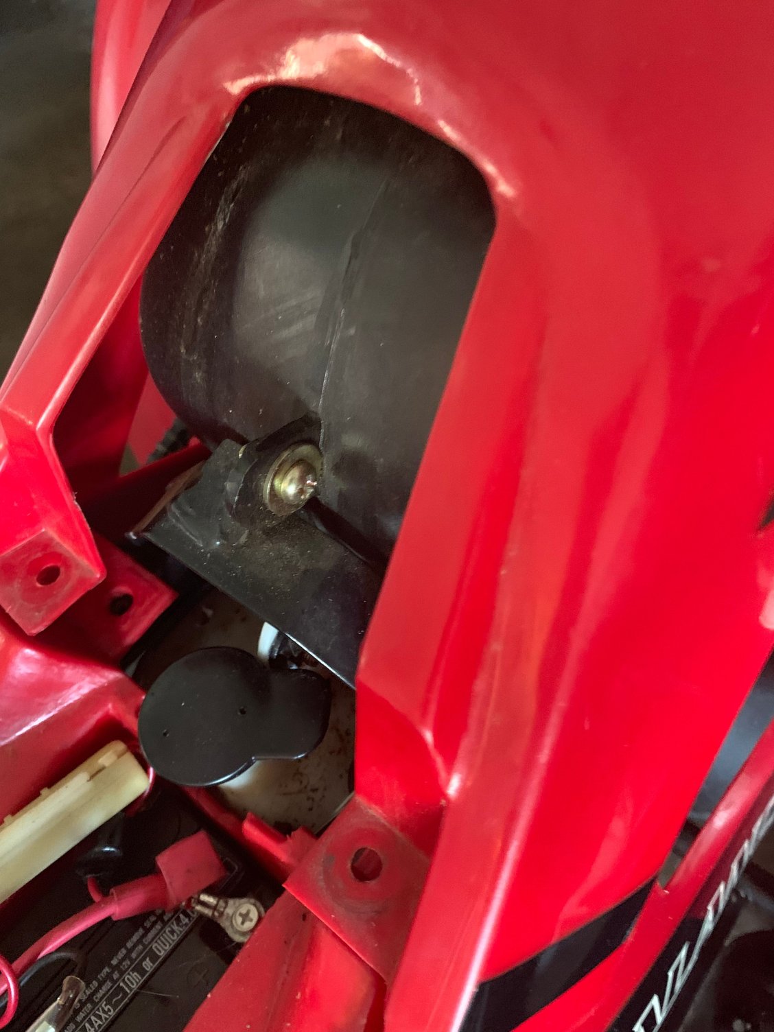

A picture of the engine would have helped. From Google it looks like a 90cc Minarelli engine, if it is a two stroke, that is what it will be. Apache, Polaris and a host of others used the same engine, so carbs for them may be easier to find. Most were electric choke, is yours?
It has a oil container near the battery, looks like it mixes the gas and oil. I don’t see a manual chock on it.
Oil bottle
One side of engine
Full view
Other side of engine

Yes, that looks like a Minarelli engine. Bike looks in good order, and has an electric choke. Externally the carb looks OK why do you want a new one?
