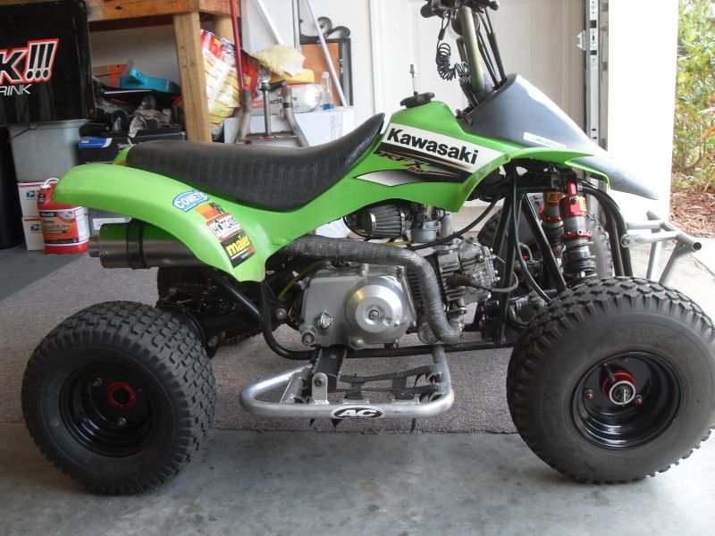

First of all is you'll need to get the VIN off the quad. It's not a LT/KFX 50. Those were last made in 2005. Then came the Z50 for Suzuki.
2006 brought in the Kymco which the machine pictured may be.
