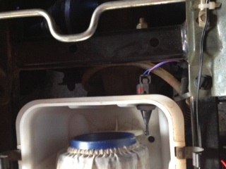

Can someone tell me what these wire-harnesses/sensors are?

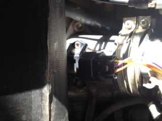

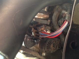

First pic is of an air temperature sensor(just keep the dirt wiped off) second pic is of the TPS or IAC sensor(hard to tell on the pic),third pic is the T-map sensor. What year model? OPT

As long as you ordered the correct sensor harness repair kit for the 500 and not the 800 it should just have the connector end and about 8-10 inches of wires that you replace the existing fine wire connector and wiring with and tie into the main harness. You don't have to replace the air pressure sensor as it's called in the parts breakdown or formally called the map sensor (manifold absolute pressure sensor) itself OR the T-bap (temperature barometric air pressure sensor) on the 800. Basically they are have the same functions. The sensors are almost never the problem unless tampered with,just the thin wiring and connectors especially on the 500 map sensor wiring that cause erratic idle,dying,popping back etc at low speeds.

The one in the air box is the air temperature sensor! The one on the manifold is the MAP(air pressure) sensor. Two different sensors entirely! Confusing I know. They both send info back to the ECU/ECM(or brain box as some call it) which determines fuel mixture depending on temperature and air pressure! OPT
